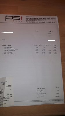

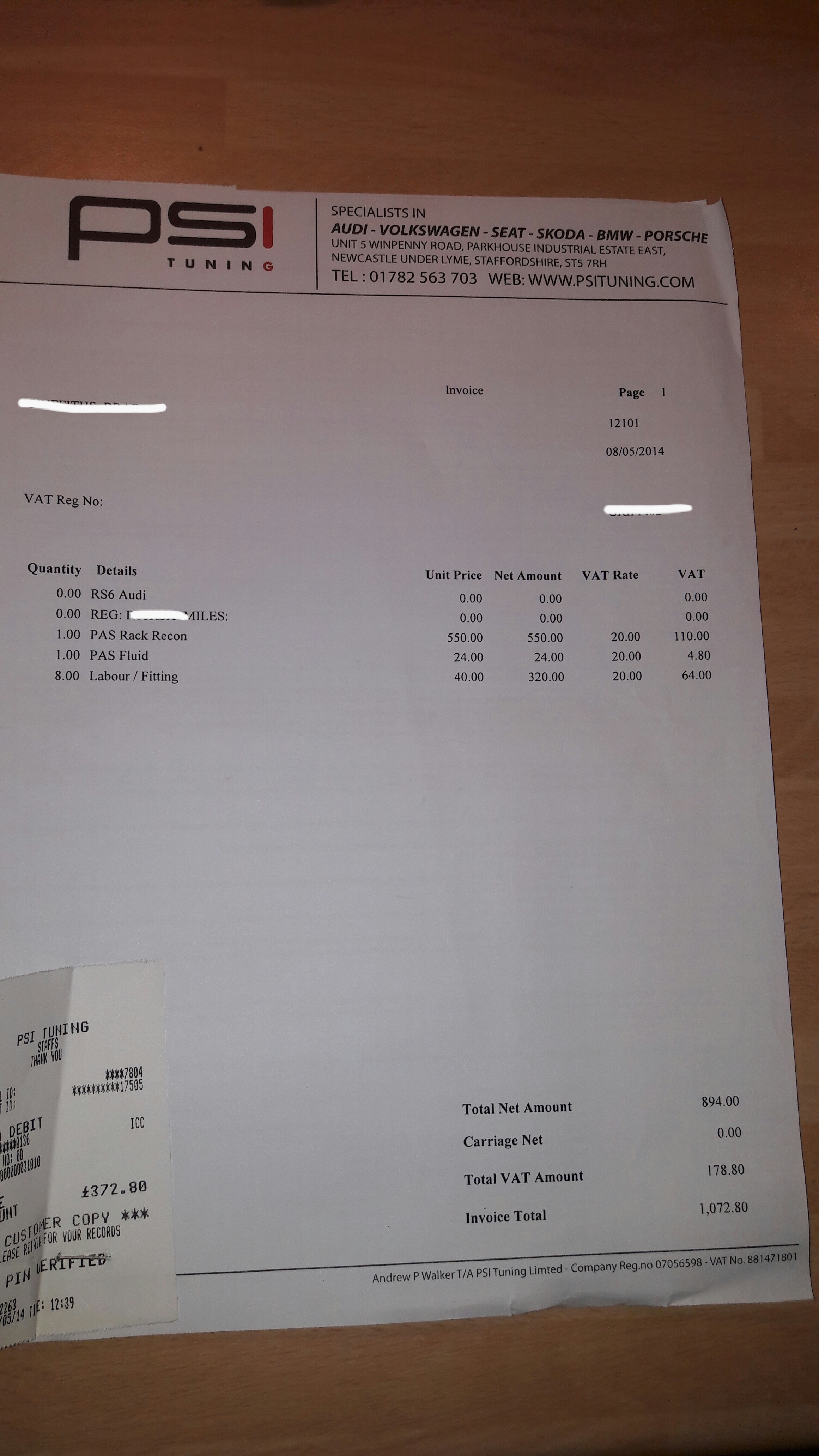

Re: Engine Out
Here we are. Had a look through the receipts box and found it. Recon rack £550, 8 hours labour. Big job but 8 hours labour only gets the engine out and that's if they've done plenty before.
Not very local to you but PSI Newcastle under Lyme did mine, £320 + tax labour....it was 3 years ago though so labour rate is probably increased but they know their stuff (mechanically anyway, no good for getting the most of the hybrids; MRC all the way for that

Re: Engine Out
I can read the invoice,Weiß-sechs wrote: ↑Sun Aug 06, 2017 9:45 amHere we are. Had a look through the receipts box and found it. Recon rack £550, 8 hours labour. Big job but 8 hours labour only gets the engine out and that's if they've done plenty before.
Not very local to you but PSI Newcastle under Lyme did mine, £320 + tax labour....it was 3 years ago though so labour rate is probably increased but they know their stuff (mechanically anyway, no good for getting the most of the hybrids; MRC all the way for that)
But no way in Gods green earth did they remove and refit the engine and box in 8 hours lol
Deffo sounds like they are the people to see for a rack swap though
