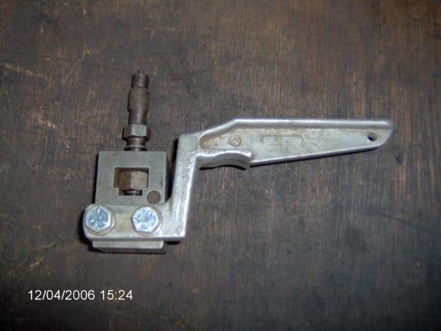

My one fits nicely in a vice - that's how I always do it. The ones I linked to above are a little different, but the principal is the same.
Actually - found a pic online of the exact tool I have. I dunno what brand it is, I bought it in Les Smith in the early-mid 90's I think.
With just a little care, reliably able to produce a decent flare. Always been tempted with one of the hydraulic ones, but I just don't do it regularly enough to justify the £.

Oh! There we go - google image search. It's Motaproducts 'Easyflare'.
