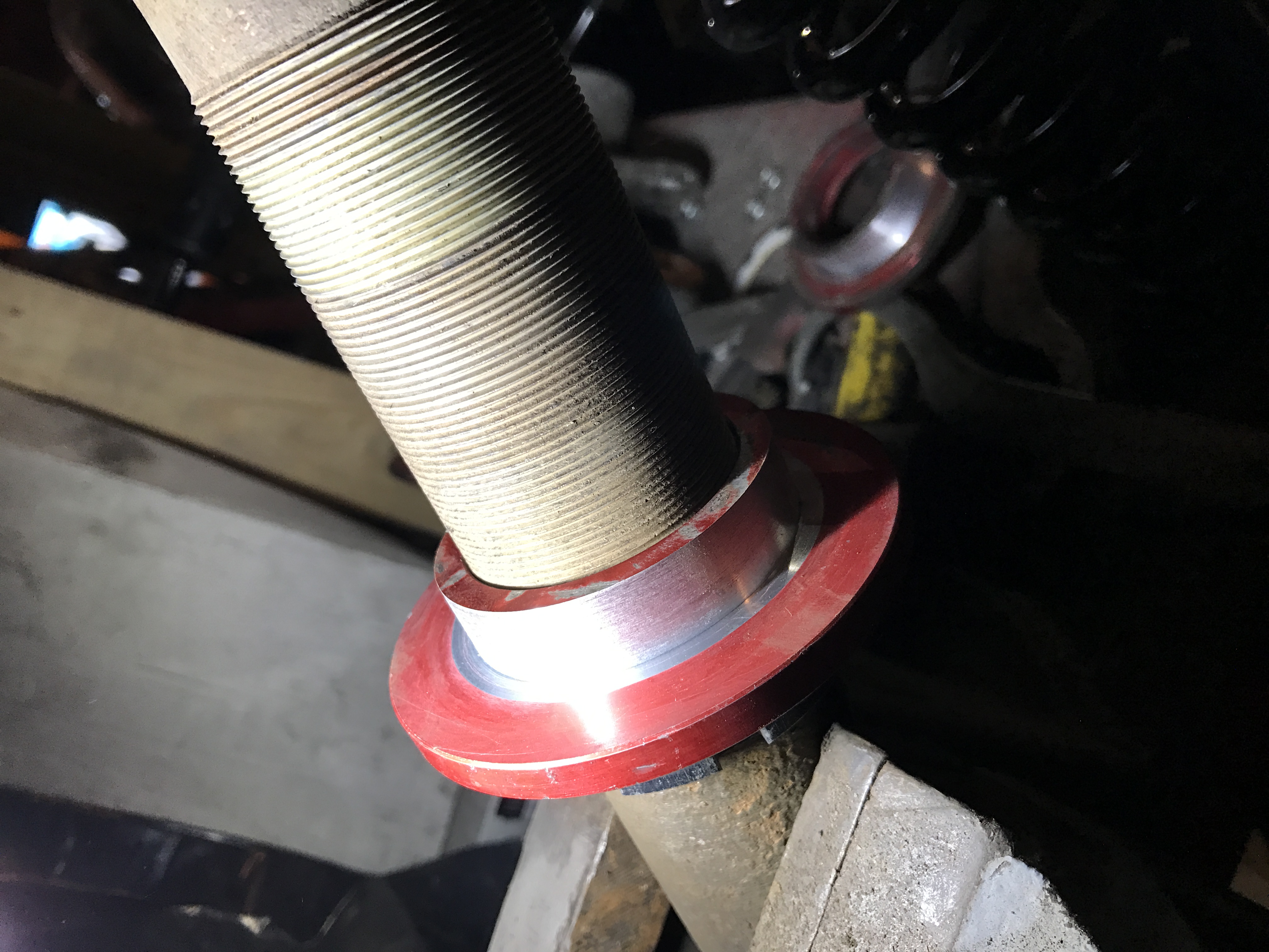

Spring rates based on PSS9's, required some machining of spring perch and had to have some custom top cups made as the H&R shocks are too long in my opinion.

Perch machining
Perch
