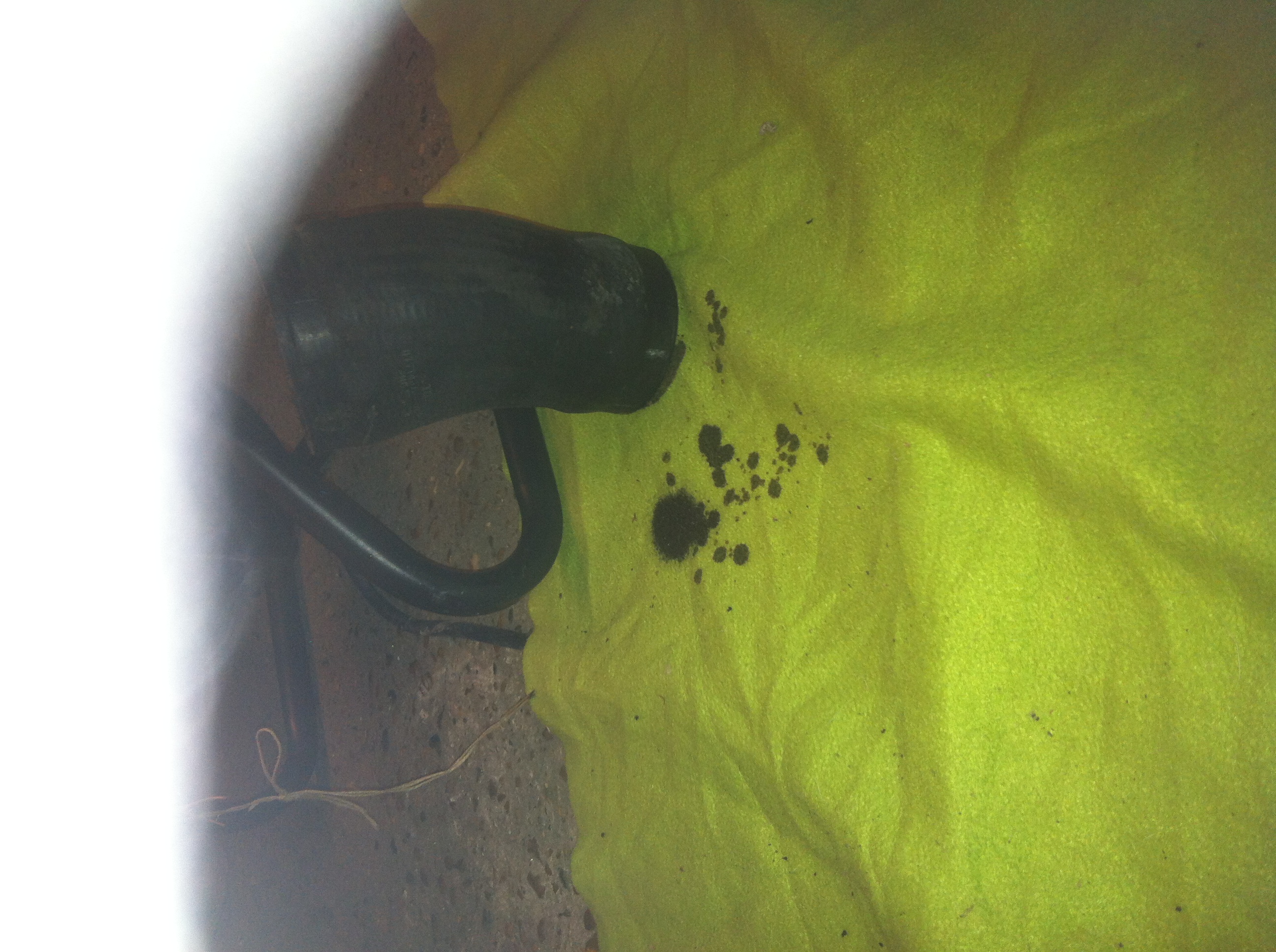

Think its normal oil coming out of the ic hose?

Re: Alternator time
Yep, I had a little more actually. Good luck!
