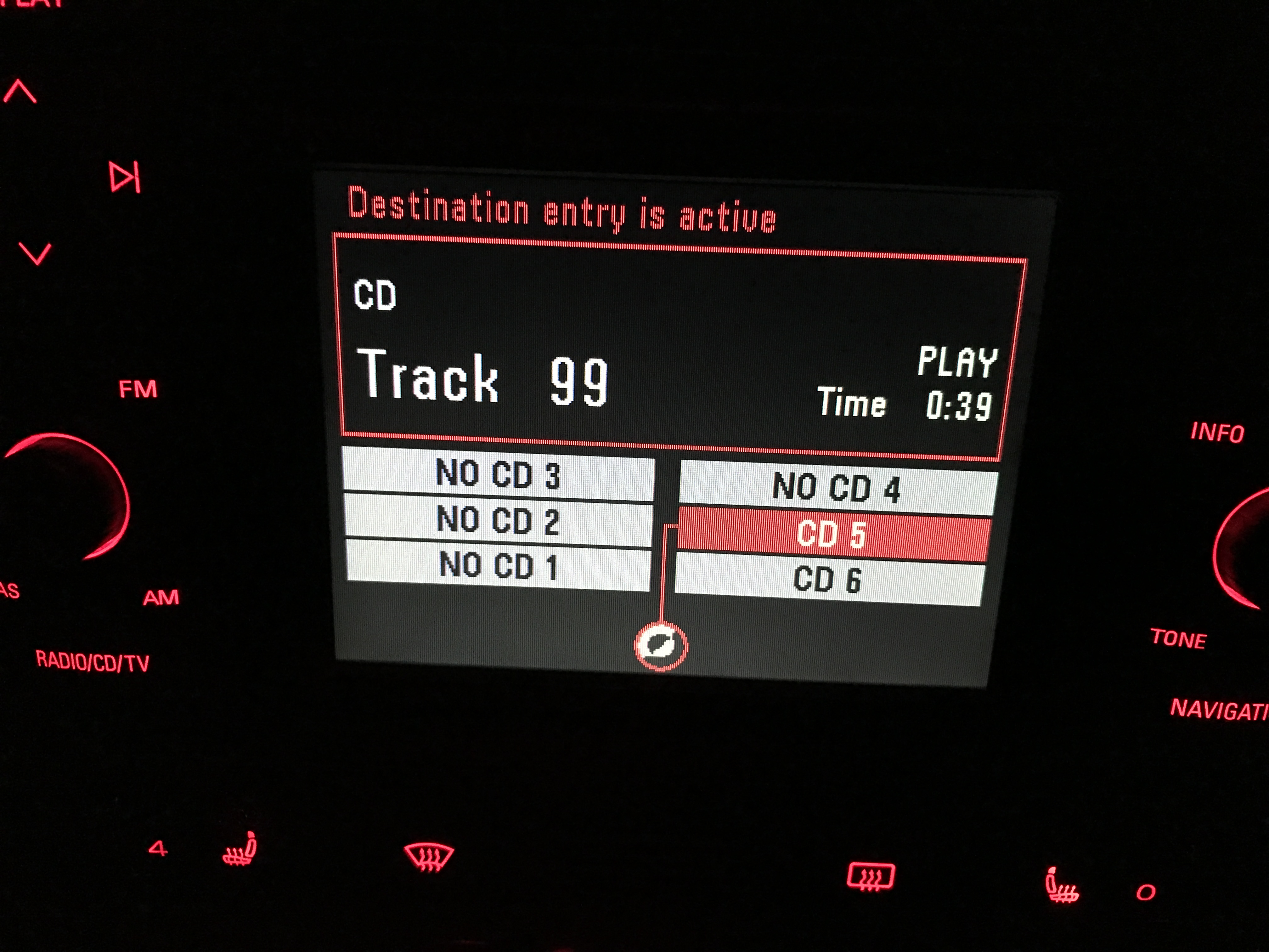

Tried to load the CD changer up on Friday as was heading away for the weekend. Changer ejects the cassette fine, loaded the CD's, reinserted cassette and it reads the CD's one by one then goes back to the bottom of the cassette as though it is waiting for the head unit to select a disc.
Problem is the unit just shows no cd on 1-4 then on 5 and 6 it thinks it has a cd but it's silent and runs constantly even with the changer cassette removed.

A CD changer with power will scan the CD slots when you put a cassette in in a rather "mechanical" way, probably irrespective of being connected sensibly to a head unit.
So, yes, if there's some sort of iPod interface, which normally looks like a CD changer for that vintage, it's quite plausible that is the problem.
What is the head unit - looks like an RNS-D? And what is the iPod interface?
Though what is a bit odd is that (I think) the CD changer is usually powered down the cable from the RNS. Maybe the plug/connection has been disturbed, I think the CD is the blue block of the blue/green/yellow big splittable plug.

It's a dension iPod connection and it is an rns-d
Will they have swapped the plug for there's or spliced it in?

I personally have no idea how it's fitted; hopefully someone here has one and can advise, or find the exact model and a manual. Or look at the wiring, which will tell you for sure.
I'm familiar with the XCarlink equivalent and that is sort of "spliced" in with a loom they provide and you can run BOTH the CD changer and the iPod (and other music interfaces) in a sort of "flip-flop" manner selected via the RNS-D RADIO/CD/TV button.
Note that Track 99 sort of suggests it's an electronic pseudo-CD telling you that as 99 is the maximum track number via RNS-D and obviously a "real" CD never gets anywhere near that.
Does the Dension have any storage, e.g. an SD card or USB stick in it?

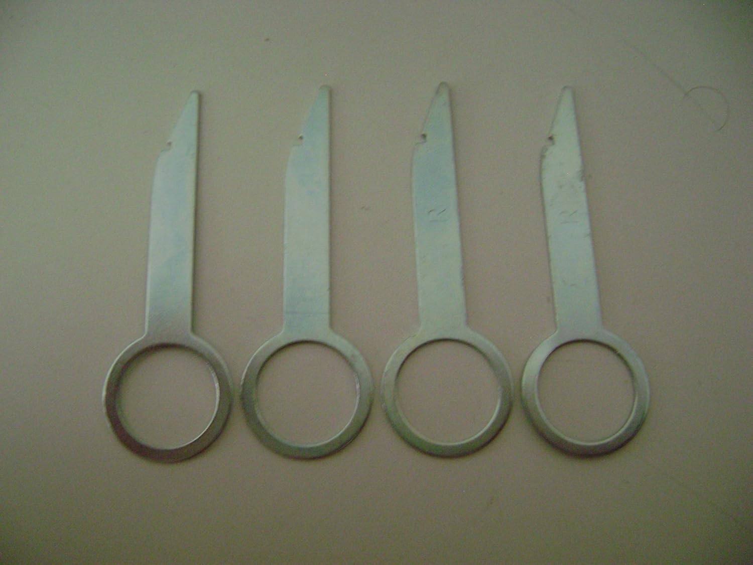

Is there an easy way to get to the back of the unit without removing it? Through the glove box?
Re: CD Changer Problems
I doubt it, get a set of 4 removal tools, takes seconds to pull it out.
