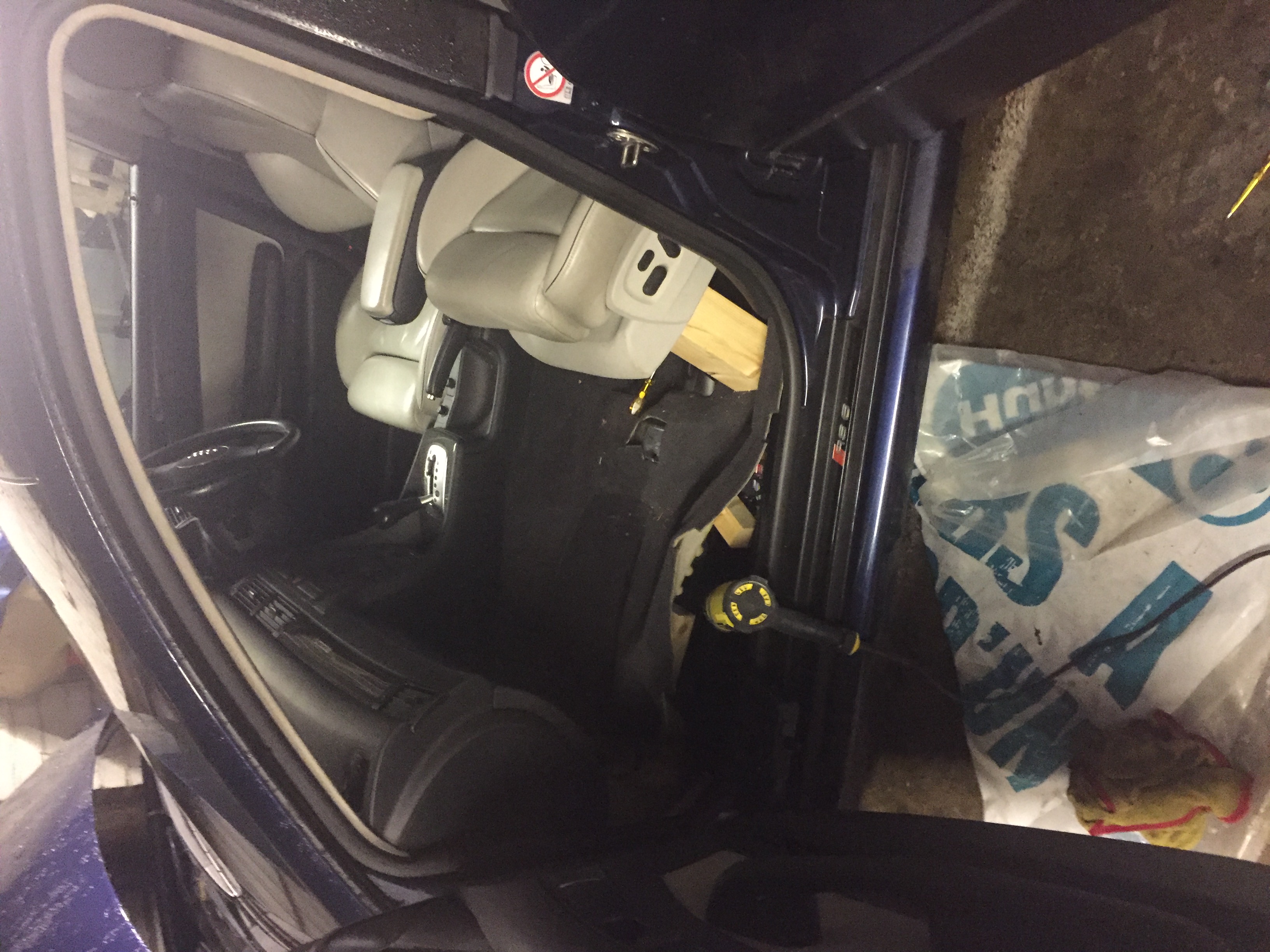

Re: Water in rear passenger footwell, RS6 C5
It's a fairly straightforward task.
1. Remove the piece of plastic trim between the carpet and door rubber (just pops out, get a good grip on it or it will remove your fingernails)
2. Remove the plastic side trim below the glove box (2 screws, one hidden under a plastic cover)
3. Remove passenger seat (total pain in the a*se, seat needs to be fully backward (I think?) to expose the two bolts on the front of the seat at the base (13mm?) take them out, remove the two covers at the back of the seat runners (just pull off) lift the seat up like the picture Then have a look at the wiring connector, probably a wise idea to disconnect battery at this point, making sure seat is at an appropriate angle to fit out of the door. Then you need to disconnect the 3 plugs, (red, green and black I think) total pain to release, not helped by the angle you have to work at. When you get them loose slide the seat off its runners and place it out of the car carefully. Then you can lift the carpet up more for better drying.
I pulled the the carpet from around the floor air duct and used the slit in the carpet to hook it around the centre arm rest for support, you will need many blocks of wood and a heat gun to dry everything out and towels.
It's a pretty tough carpet so you shouldn't ruin it too easily, just don't use a heat gun on full whack!
