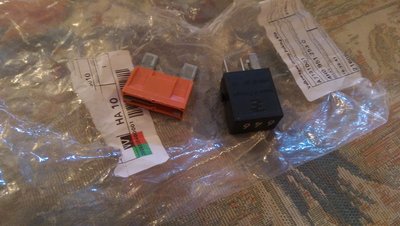

Hi im looking for the relay or fuse for the secondary air pump I think from looking at sum other posts that its along side the engine ECU ? So if anyone knows for sure it would be a lot of help thanks :D

I've removed a relay next to the ECU with 395 on it and ordered a new one for tomorrow £17 hopefully this will make my brand new pump work :-)

Bad news fitted the new relay today and pump still not coming on a cold start but least its booked into the garage tomorrow!

I got some news on this and its good collected my car from the garage yesterday and its all sorted it was the fuse was gone but I bought and changed the wrong one i was in the right place its in the same fuse box that the ECU is in under the hood but its not the reley but this big looking fuse to look at it diddent look gone but on a closer look u could see it was cracked in the middle so glad its sorted :thumbs:

Sorry I didn't see this sooner. Yes, the 40a fuse is the sai. The 10 amp one is the after run coolant pump.
