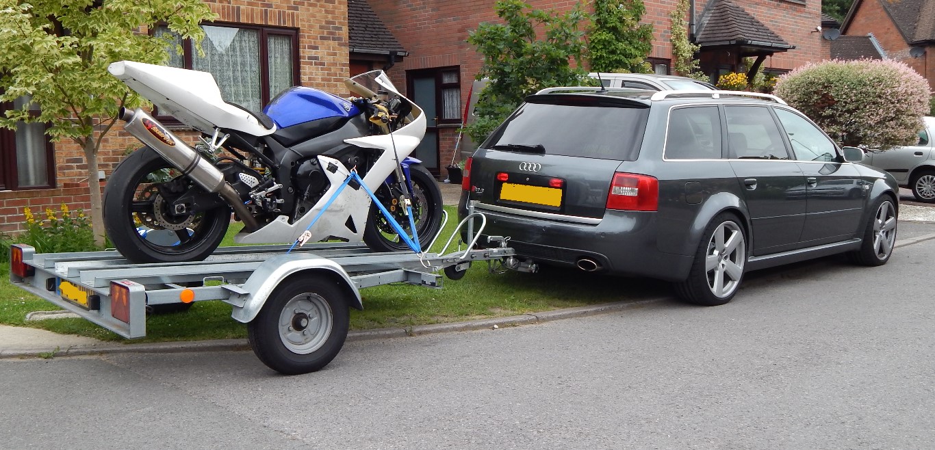

I got a factory fitted westfalia towbar from an A6 Allroad, it fitted perfectly, no bumper trimming required and the electrics flip up out of view so even if you were under the car you wouldn't see if unless you were looking for it. I'll get some pictures uploaded when I get back from work.
I do exactly what you want to do, towing track bikes. Usually an R6 and R1 on a double trailer, the car tows absolutely superbly, It's a joke it's not rated!

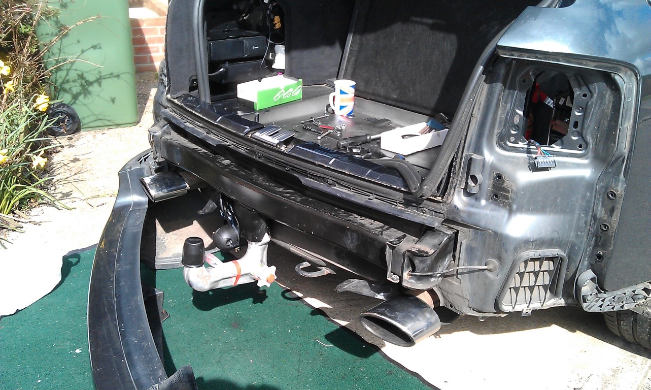

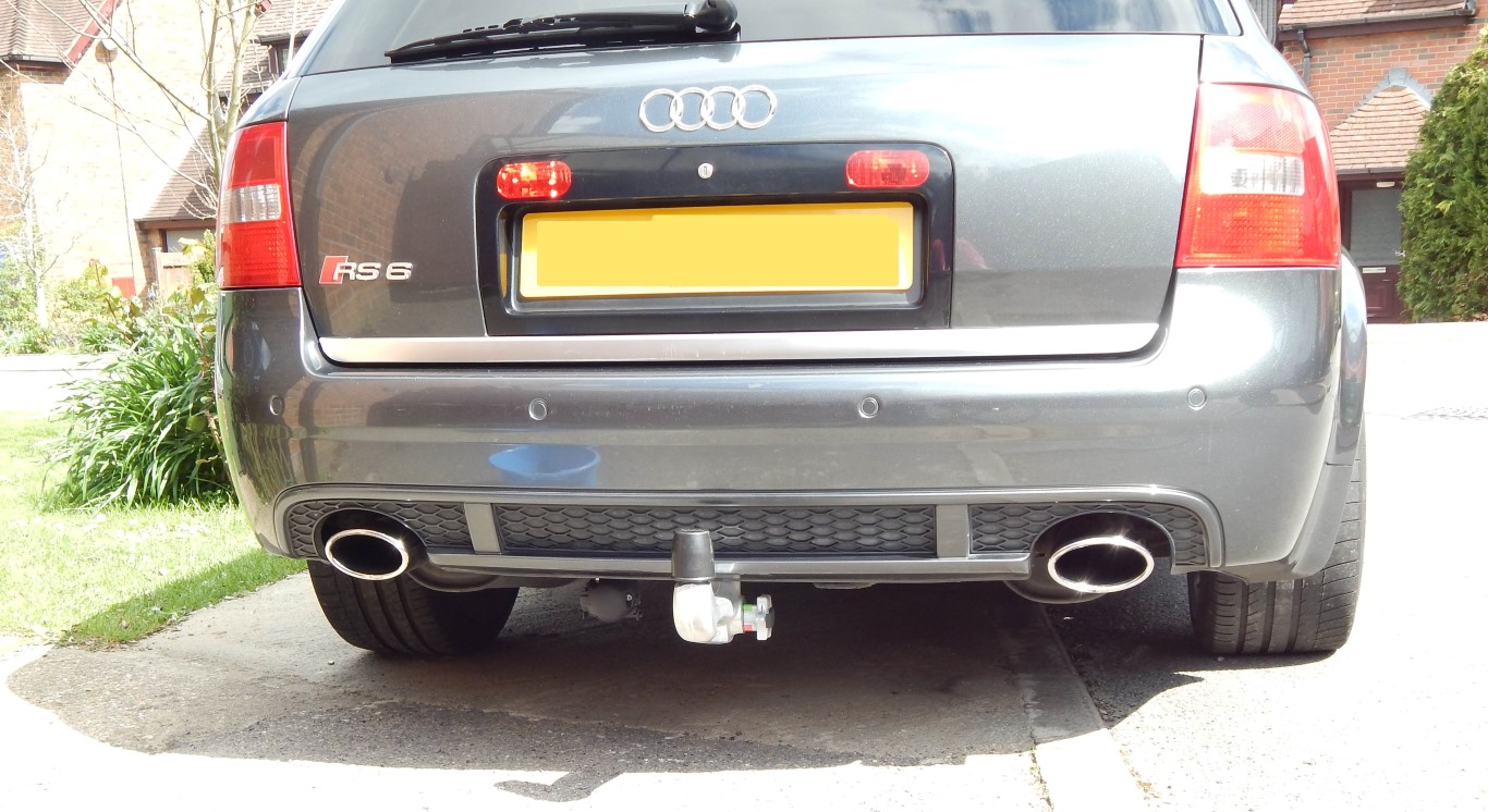

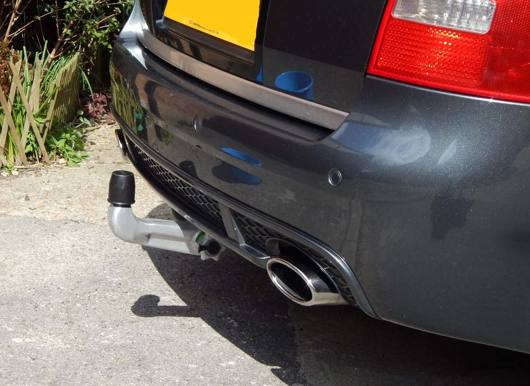

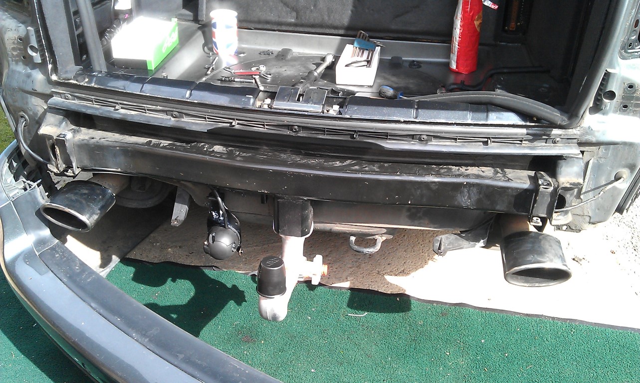

So this is the towbar from an A6 Allroad, it's not really as in depth as it looks but took some patience.
Electrics flip down for use, and when flipped up are totally concealed as you can see by second to last pic.

Magpie, it's pretty straightforward, you should get a relay box in the kit, all you do is connect the wires for the towing plug to one side, and on the other side you need a 12v feed from the lighter socket, then the only bit that takes a bit more patience is finding the 12v feed going to each type of light and wiring that into the relay box. I might be able to help talk you through it if you got stuck, or any decent mechanic should be able to do it.
