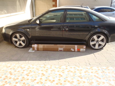

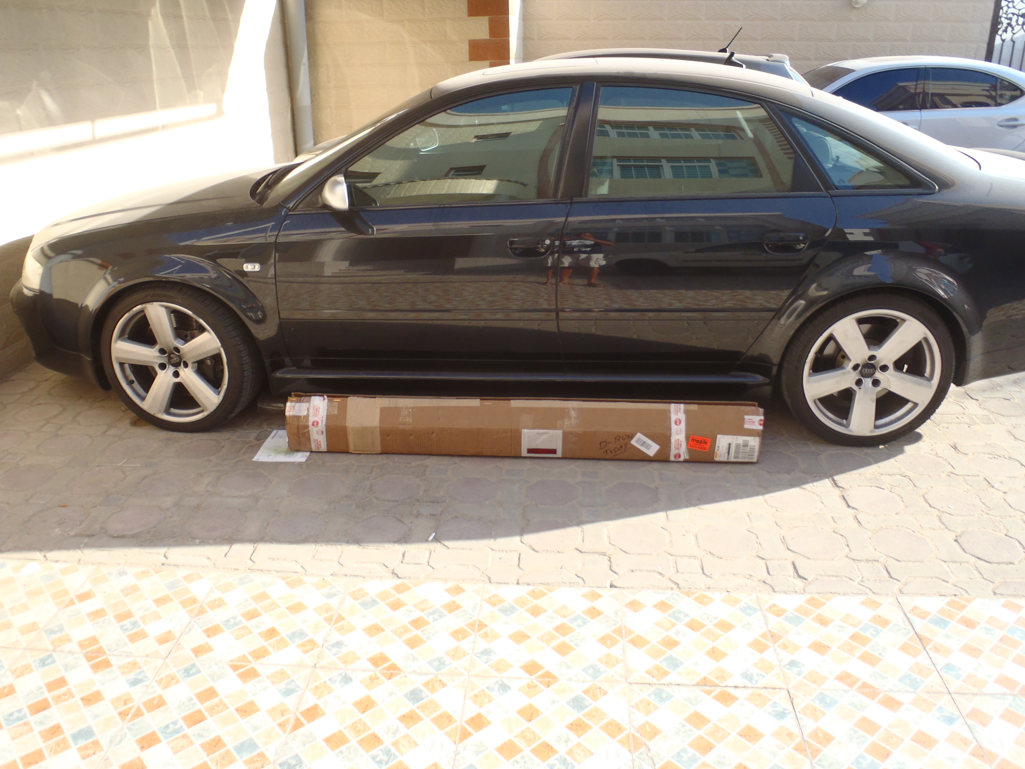

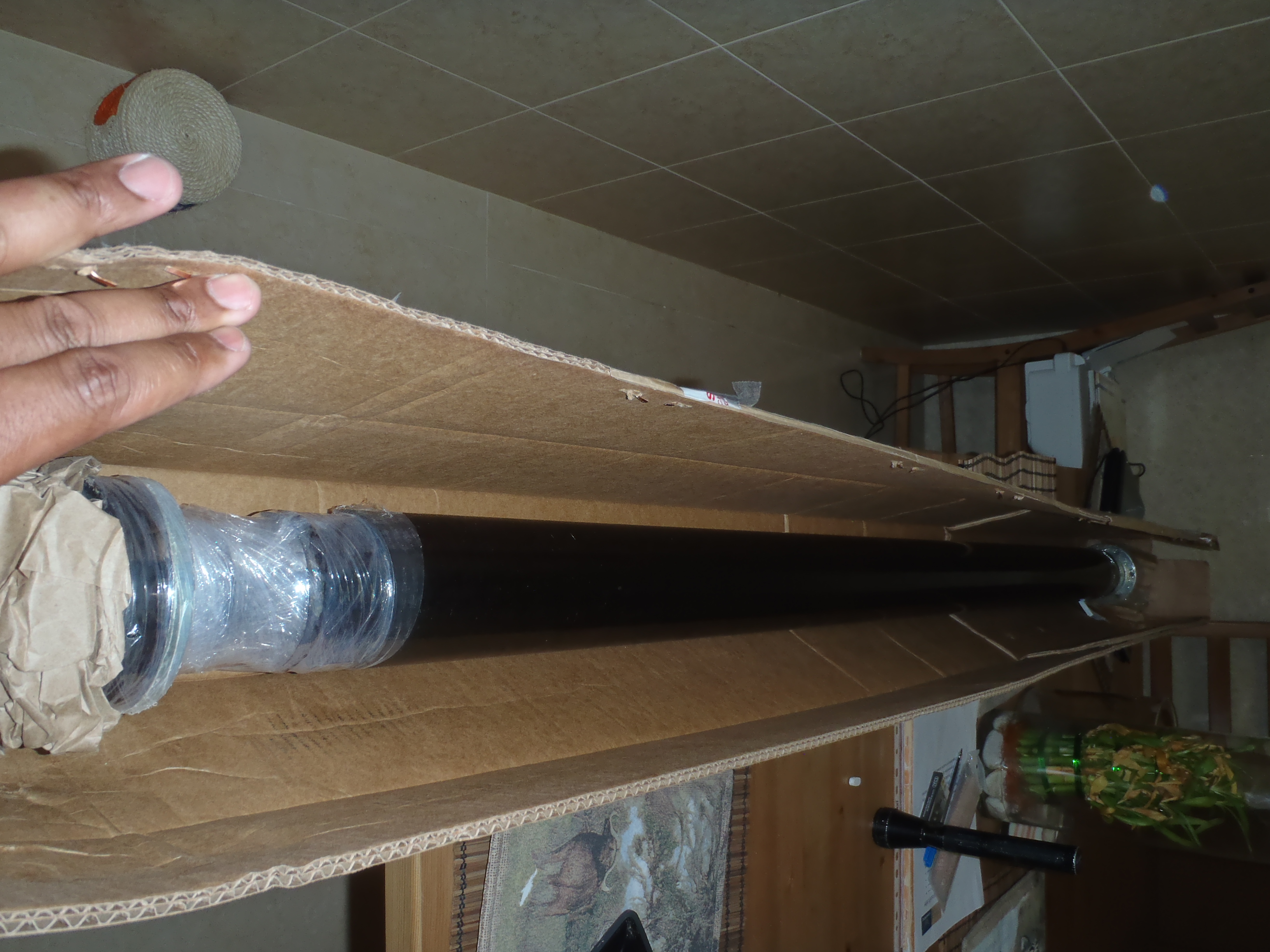

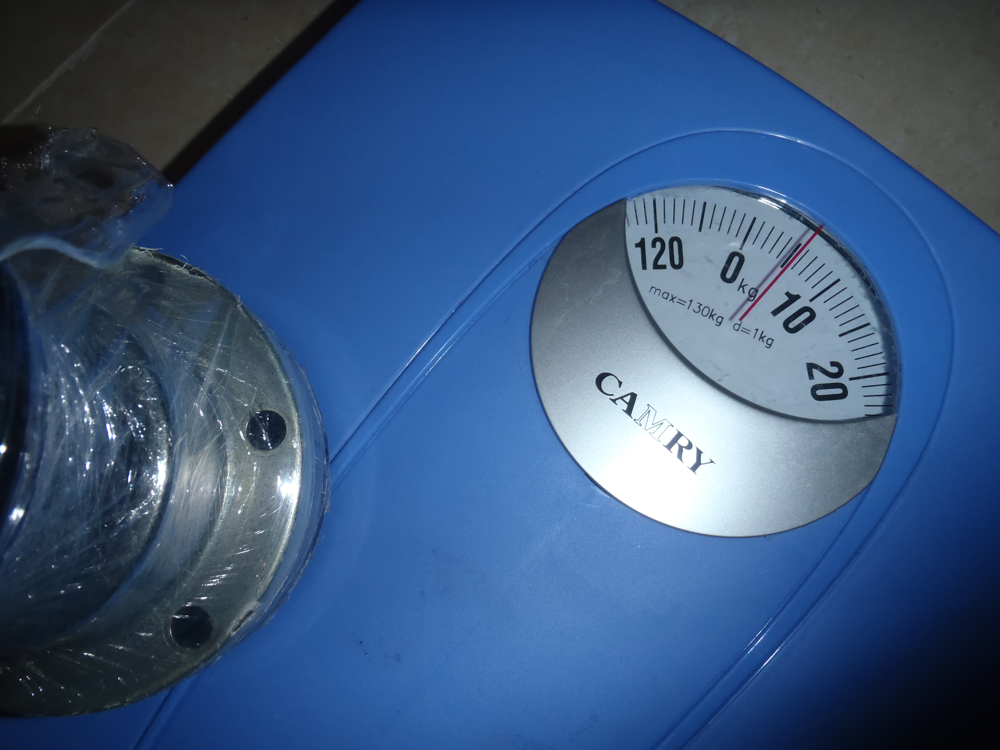

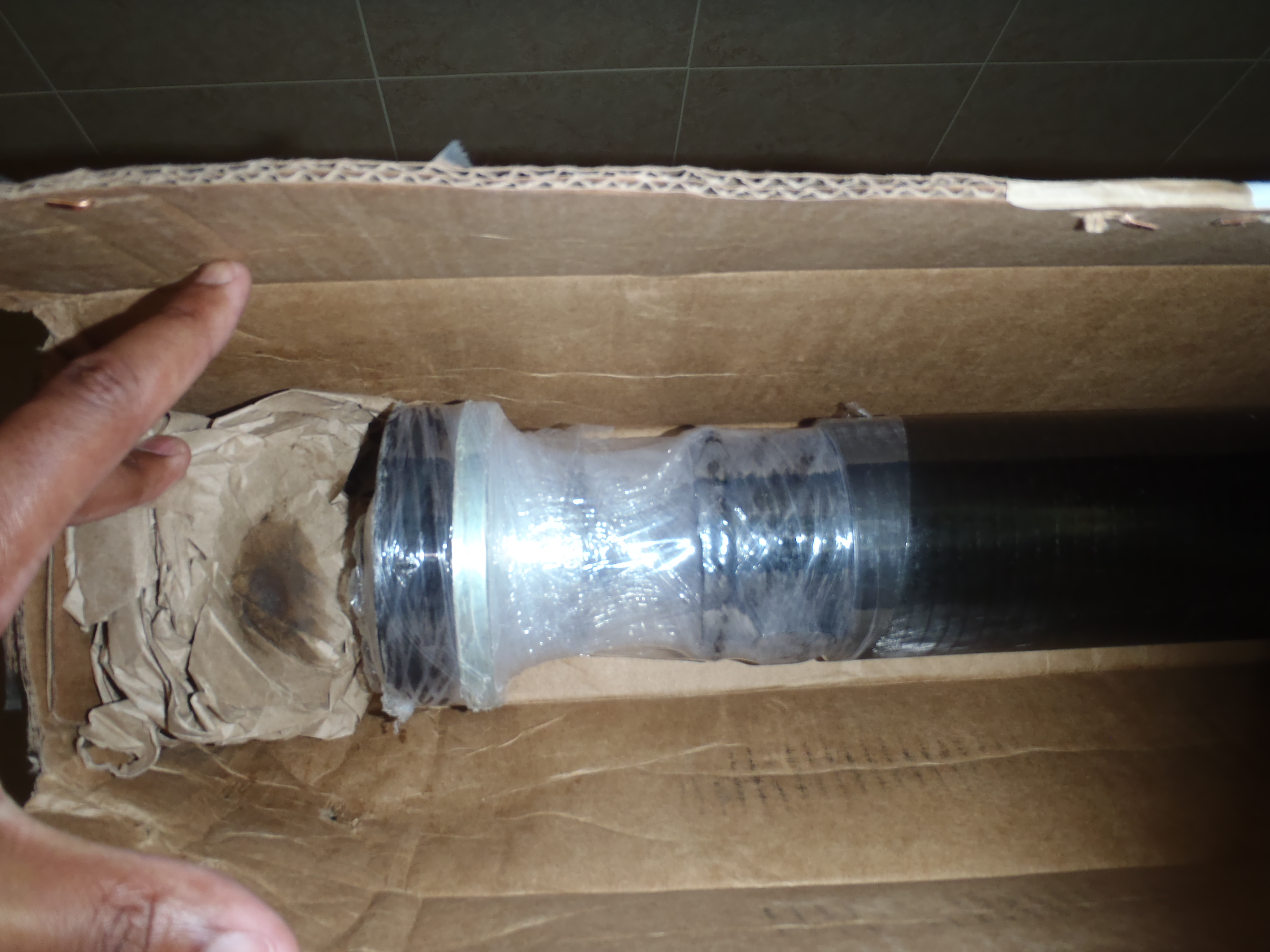

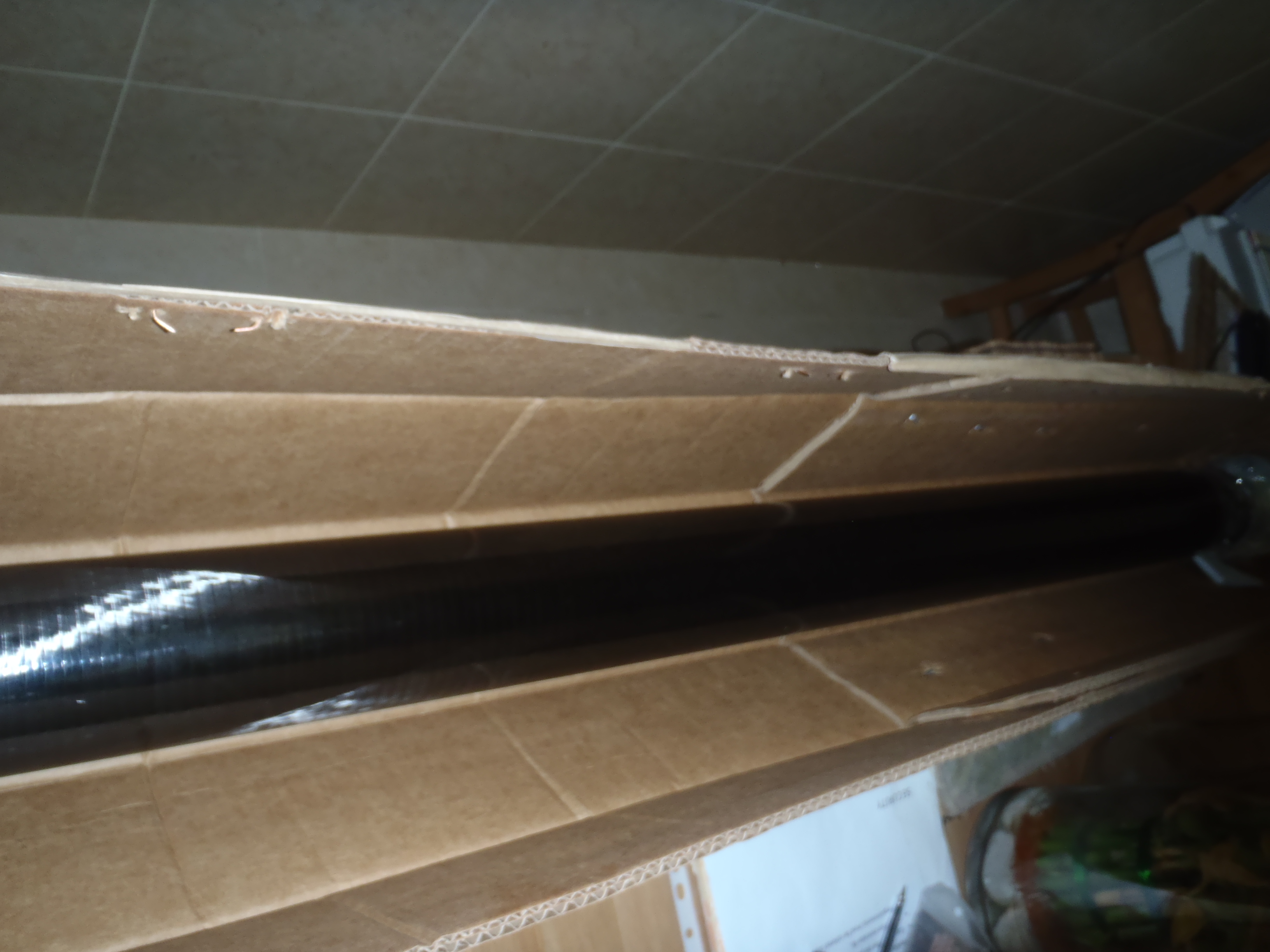

So, merry christmas to me finally got my carbon fiber shaft,
I'll probably get booed off the forum but what the hell I always wanted one and it was the same price with shipping for a brand new one from audi. Here are some pics of it once installed I'll let you folks know how it goes. It shows 5kg on the scale but it's off by two to the negative so I'm going to say the total weight is 7kg. I'm pretty excited yes bam bam this is the complete unknown. Ahhh what we do for the sake of science right?
Hope you guys enjoy as much as I did in finally getting it.
By the way I didn't realize it was so friggin' long

Very exciting stuff.
Always good to save weight, and will reduce rotating mass, too.
What torque is it rated to?
No center bearing? Not necessary?
I'll be very interested to see how this goes.
