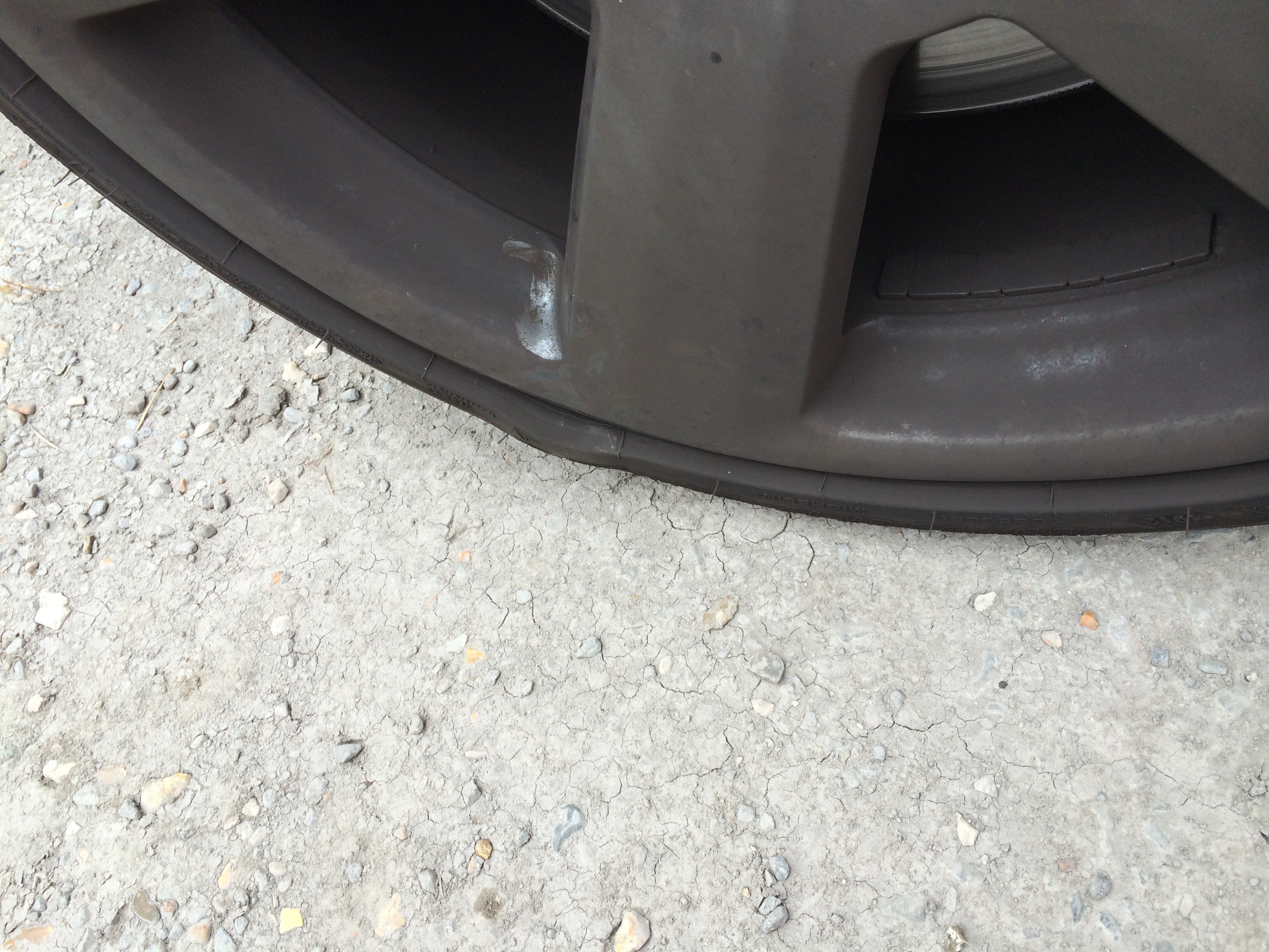

Drove out to country pub for carvery and noticed this on front near side tyre . Don't want a blow out, no damage to tyre or alloy, just noticed the bulge which isn't apparent on any other tyre

Ekkkkkk.......if its not too far then drive home very carefully and then get a new pair is what I would do :bigwave:
Not good is that bulge :drink:

Top toe is the key. As above that is a failed unrepairable tyre.
If there is no air being lost the my money is on one or more failed steel cables (that near the bead suggest could be that one and that holds the tyre to the rim)
Otherwise it could be the inner canvas failed and is pushing the outer rubber into a bulge.
Either way that is something to not drive on and certainly not motorway speed.

Holy moly... Send the wife and kids back in a cab

Nope. Set of for Unit 20 from Glasgow; had battered deep pothole from the bad 2010 winter with nearside front. En route the car was vibrating and mayhem. Pulled off the road and had a right good look. Couldn't see anything. It was the carcass of the tyre bashed and bulging from the trauma of the pothole but all on the inner surface.
Immediately spotted by Martin and a 'get home' tyre for free to get home and get full replacements.
