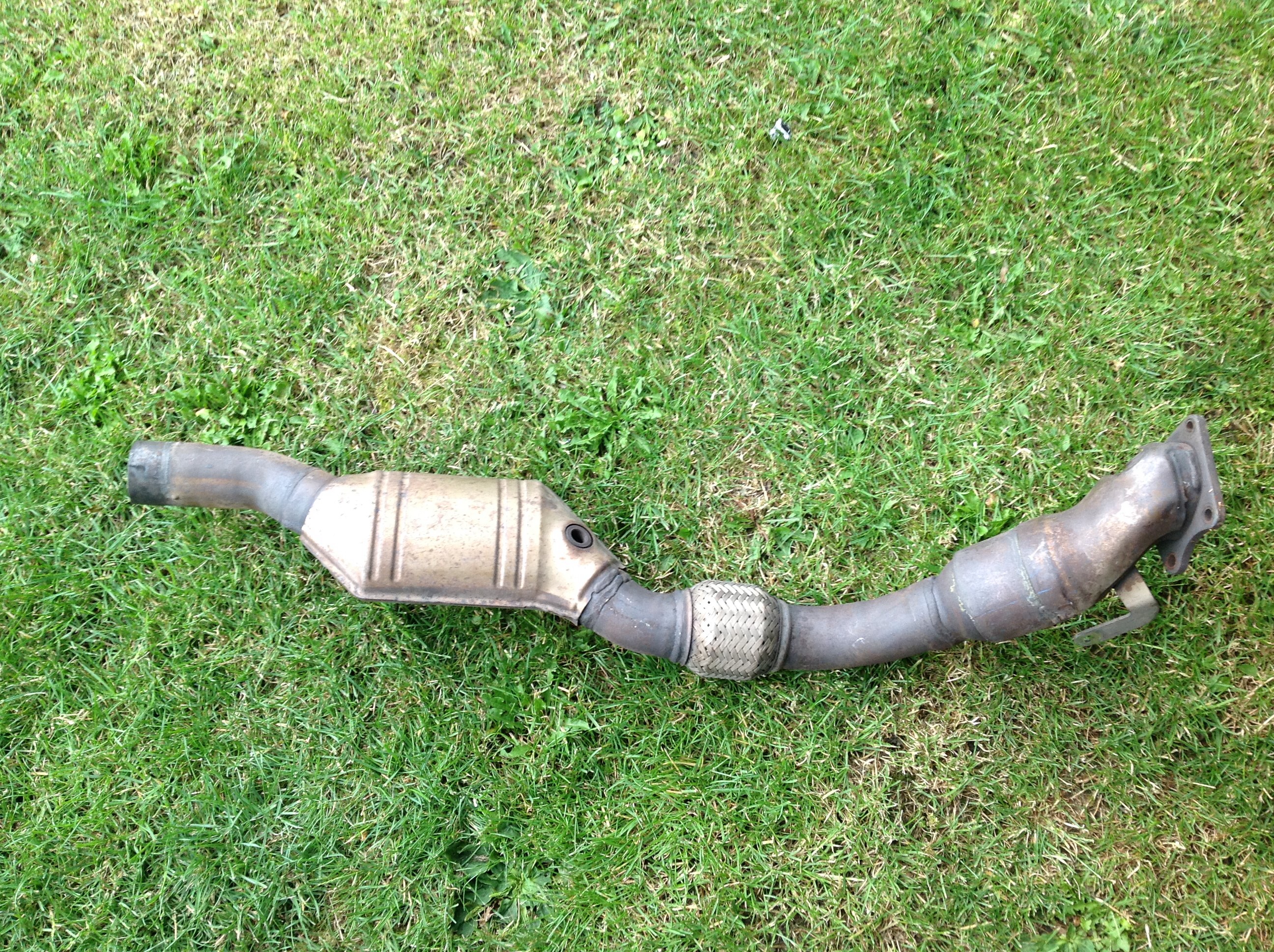

Jangol,
I think I've got one of those exhaust sections in the shed.It came along with my car when I bought it. I think it's the correct side?

Post by pete62 » Sun Jul 06, 2014 8:36 am
This is the part I've got. No clamps or anything else.
Is it the correct side ???????

It looks like the correct side being the drivers side!.. Not 100% sure.. But fairly confident. It is.. What do you want for it & when could I collect to fit up to confirm it is please
