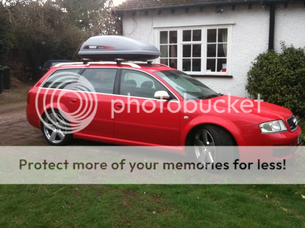

I think mine is 7 or 9 clicks on the rebound.....fwiw I would not swop my kw's for any other set up :assflash:
As you can see she's nice and low on those kw's :bigblink:
950 nm torque!
ahoooga
Posts: 1105
Joined: Thu Dec 20, 2012 11:14 pm
Location: Well in front of that RS4
Re: Ridiculously hard ride
Post by ahoooga » Tue Jun 03, 2014 6:01 pm
Are you sure its not low because of the weight of your handbag you've left on the roof in the picture :jump_clap:

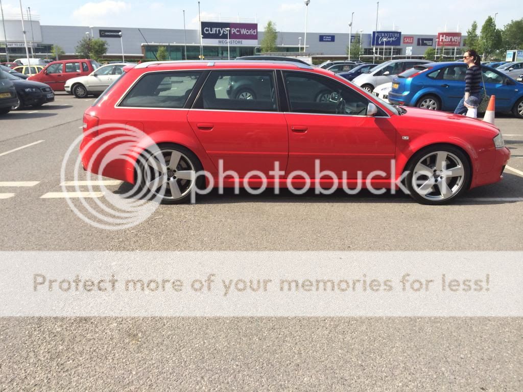

Post by amanda1 » Tue Jun 03, 2014 6:09 pm
ahoooga wrote:Are you sure its not low because of the weight of your handbag you've left on the roof in the picture :jump_clap:
Yes positive ...........my handbag was empty :bigwave:
A more recent one then without the handbag ;)
