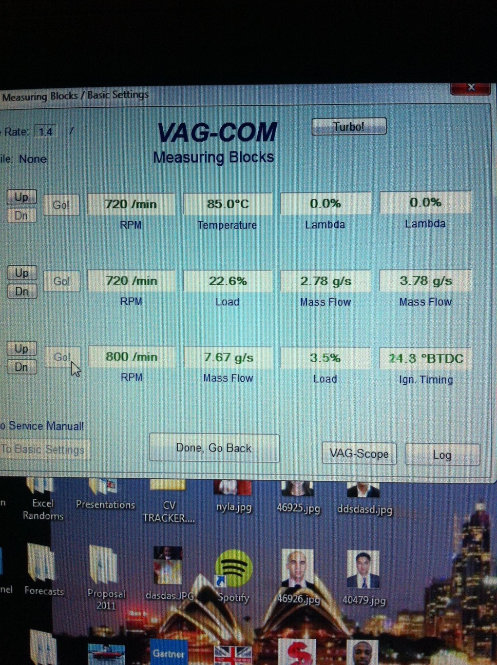

right, hooked the Vag-Com up and the results are.

Bit low on bank one. What happens at 2k rpm?

all good at 2k i think mate, why?Shoppinit wrote:Bit low on bank one. What happens at 2k rpm?
Do you think that the low reading on bank 1 could cause my issue?

shall i take another reading at 2k?
