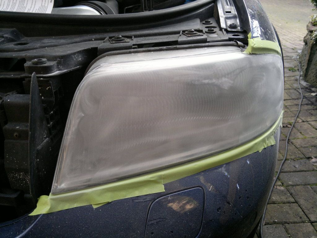

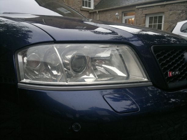

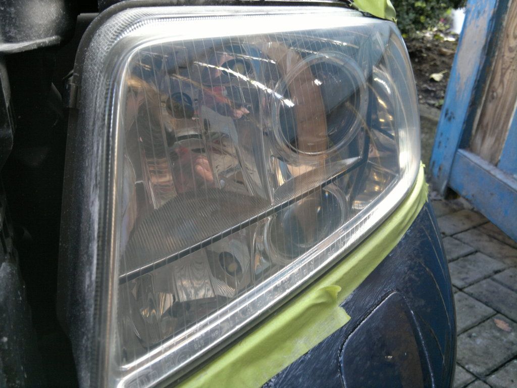

Before:
During:
After:
Used a £25 3M headlight restorer kit. You'd have to be a complete numpty to cock it up!

Nice job. I'll look the 3M kit up.

Gripper1 wrote:Before:
During:
After:
That's pretty good, all you need to do now is re protect it.

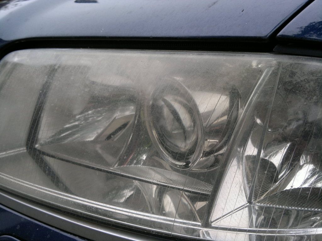

chunky79 wrote:Post a pic 1 year after when the sun has got to the unprotected lens. I agree then lens looks dump when scratched but it will only go super dump when the protection has been removed.
I did them Nov last year, here they are as of today:
After 10 years I imagine there is hardly any UV protection left anyway especially with the amount of hazing mine had. I'd agree a UV protector may be needed if our cars were baking in the Californian sunshine all year round, but this is the UK and I imagine most of us have garages to keep our cars in too.
The kit removes maybe .002" from the polycarbonate and that was when mine were particularly bad. If I have to remove a few microns every 2 years to refresh it, then I guess I'll only have enough material to last 40/50 years.
