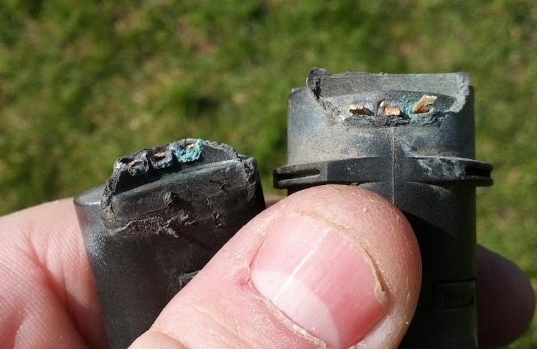

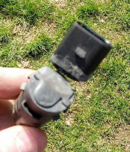

timely question
so I had something similar with the mid right sensor. I swapped it out this morning (I could get at it without taking off the bumper (woohoo)
When I had it out, it was obvious that one of the three wires had corroded through and contact was intermittent (sometimes beeped and sensors didnt work, sometimes it worked fine). the plastic connector was also a bit broken, which is probably why there was corrosion, and I broke it open a bit further to get some pics. the wire with the green deposits was the one that was broken.
pics below
and
so a quick swap later, all was well.
t.
