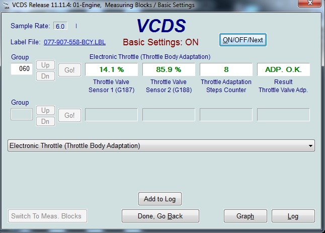

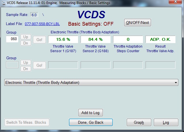

Guys, I had been doing the throttle body reset on the Cupra R since getting it as it is actually beneficial on those and actually don't have much on today so I went and did both the Shopp guide and the Bam guide. Gave me an excuse to go out and spank her for 20 minutes after, I had forgotten what kickdown actually did, being that long since I didn't use Tiptro. Only lost the brakes once Shopp, hopefully that didn't kill your spare pads too much dear.
I took 2 screengrabs after running the adaptation twice in fact, for the hell of it. Are those values what you would expect to see?
Thanks.
Thanks.

Re: RS6 Flat battery problems, pls help!!!!!
Yep. Ben has my dead throttle body and has taken it to bits for fun.

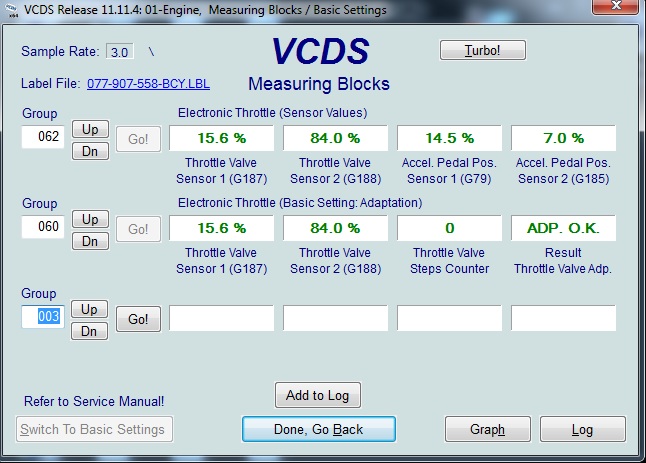

I checked mine the other day and the throttle was opening to 98%. What is yours opening to when you check in measuring blocks with the engine off?
Those were all done with the engine off, stone cold. Will go and have another look if you want? Can you remember the number(s) of the measuring block(s)? Sorry if being a muppet.
Group 62.
Tell us what the 4 zones say not touching the pedal and full throttle.
No, that's correct for a TB adaptation. 14.1+85.9=100 and 15.6+84.4=100 I'm pretty sure these positions are correct for engine off. The adaption is on block 60. Logging throttle opening will be on block 62.Mr Footlong wrote:Just checking as if I am losing even a smidge of available power courtesy of non-full range then I want it swapped out thanks.
Sorry, I wasn't being clear. I was talking about the values in the measuring blocks.

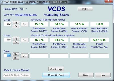

Lol, mong.Mr Footlong wrote:Are those values what you would expect to see?
Mong again in reply to Bam's reply as I didn't cotton at all about the 100% sum of the two values.......
Right, the values you asked for:
Current:
Gone:
Gone:
