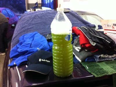

Weird read this last night then went out for the shopping only to find my rear passenger floor soaking even though the rear washer still worked. Pulled the front seat and carpet up today and found around 2 litres of washer fluids sloshing about in the wheel well.

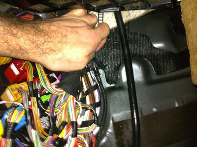

Traced the issue to the rear washer pipe just as it comes into the car in the front passenger wheel well. Bloody stupid place to put a joint if you ask me what's wrong with one pipe all the way from the pump. Thankfully the TCU box was still dry.
I've dried the carpet best I can with a wet vac but it's now sitting with a oil radiator in the car hopefully to finish the job. then tomorrow I'll set away rebuilding the inside of the car.

If you pull back the carpet under the glove box, in the corner, there's a connector. Mine had just popped apart. Suspect when there's been some cold weather and the washer has frozen.
All Ive done is pop it back together, and encase the whole thing in self amalgamating tape to make sure it cant come apart again. Suspect its going to take a while for the carpet to dry out but I'm at the garage most days anyway so I'll just keep the heater on it while I'm there and the windows open over the night.
This what the wet vac sucked out (that's a 2Ltr bottle)

Post by Dipper » Wed Jan 25, 2012 12:58 pm
perfect. cheers for the pics. i was looking at the larger pipe on the right. no wonder i couldnt feel a join! need try and get the carpet back a bit more rather than do it by braille!
