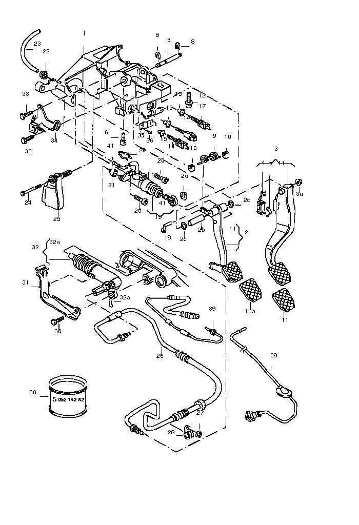

I cannot stand this vibrating brake pedal, it shakes and makes a weird sound whenever I go over anything but the smoothest bit of tarmac. I can actually move it left to right just a bit with my hand. Has anyone got the part number of the part that needs replacing and an exploded view of how to get to the bastard from etka?

As far as I am aware , there is no short cut , grizz has worked out how to rebush the pedal , but only if everything unscrews to allow insertion of new bushes , shearing off the screws is not an option to choose

Thanks Phil - there is no way I'd learn to live with this though, I'd rather trade her in for a D3 S8, it irritates me that much. Makes it feel as though it isn't secure and it's falling apart. Maybe mines worse then others, I dunno. But It's worth my time pursuing, I might even be known as a hero around here thereafter, similair to Shopinnit. I cannot believe this hasn't been documented with some Haynes esque photos and a brief write up yet

Mines has very slight movement and can onoly feel it when driving silly. When spoke to grizz about it he said it was a tinker of a job. Both him and MRC have repairs for it. Sorry but can't help any more than that at the moment. I will have a look at it the weekend if i get chance cause it can't be any harder than the machines i work on every day

MRC strap the pedal up to stop vibration and it works a treat, they did mine.

MRC put a bloody big cable tie on mine and it worked really well.
Re: Shaking brake pedal
Where did they strap it, was it a big job?

Got my hands on the diagram.
