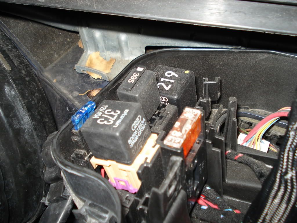

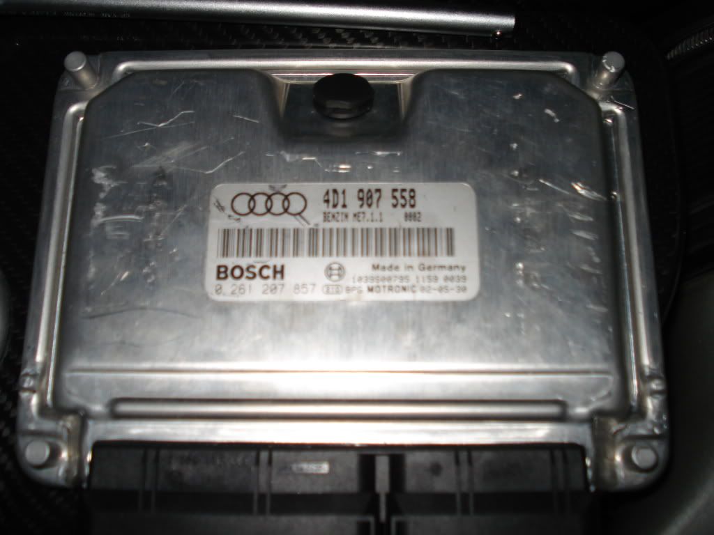

Heres an overview of my motor ecu building out...(because of the 16985 error)
Here it is, inside the black box. loose the screws, the one at the back is difficult to reach...
An unknown and unconnected wire, dont know whats that for...
The actual ECU is visible now...
Take the clip of with a screwdriver...it comes off easily...
Pull the edges to the outside, the connectors get disconnected...
Motor ECU build out...
Some fuses etc...

This error basically means that whomever flashed your car used an outdated file as the base map. You either have to have the original tuner reflash the ecu with an updated file, or like you said, have it reflashed by another tuner. I went through this a while back myself, and opted to have Rich at Viper re-tune my car. I have nothing but good things to say about Rich and his tune.

Rich from Viper Tuning put my ECU back to stock and solved the 16985 error and Viper Tuned my TCU. :biggrin3:
He noticed my ECU/TCU was remapped but couldnt say by whom.
quote:
The Map was not great, did not do much with fuelling and ignition was low so you've not lost anything imo, stock map would be better!
TCU map, not quite sure whats going on there! Best be gone with that!
It will be send back tomorrow. :jump_clap:
So im very happy with that and i hope to have a stage 1 Viper Tuning map soon...
Rich thank you so very much for your effort and knowledge!!! :beerchug:
