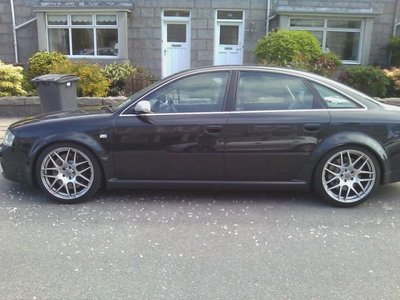

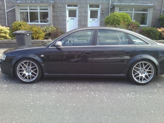

Mine was also very low , just had it raised 10 mm , transformed the ride ,and still minimal gap between tyre and wheel arch

10mm sounds about right on the front and leave the back as is,I've had a look at the manual that came with the shocks and there is nothing about how to adjust the height , well nothing in English...........Is this something I (enthusiastic amateur) can tackle or is this best left to the garage to sort out?

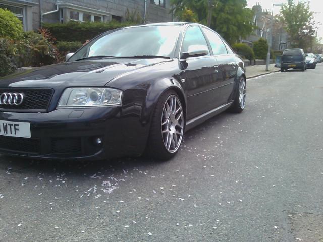

I love the look of the 2 pics with the car slammed. It makes a massive difference to the looks. I'd be tempted my self if but the drc staying im afraid for the warranty. I Keep looking at mine on stilts

The documentation with the bilsteins is useless. Comlpete waste of paper. I used the instructions for the KW shocks.bakustax wrote:Phil
Graham
You can set the height very easily yourself. Just use a bit of common sense. Eg. if you lift the front left up by 10 turns, do the same to the right, etc.
Oh, and make sure you take the weight off the strut (jack it up) before trying to adjust the height or you'll need muscles like superman.
It's funny how you all want it slammed and what I was most worried about was whether I'd be able to lift the car high enough
Re: Inevitable
Got the "C" Spanners out and went for it...thanks to Shoppinit and Phil for the advice...10 turns seems to have fixed it...no more vibration and sitting at a still "cool" height

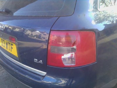

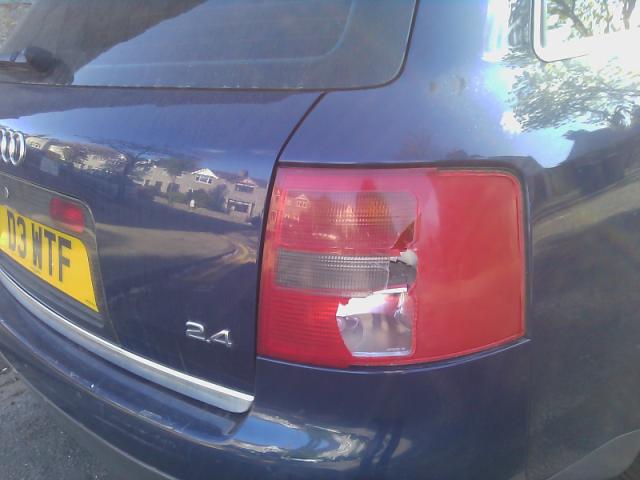

Shop............ the Multitronic is about the only bit on the car thats original!!....I've lost count of the panels and lights I've bought off e-bay to keep the A6 roadworthy..........she's just arrived back in after another bump with a tree this time!
I feel another e-bay search coming on......either that or
