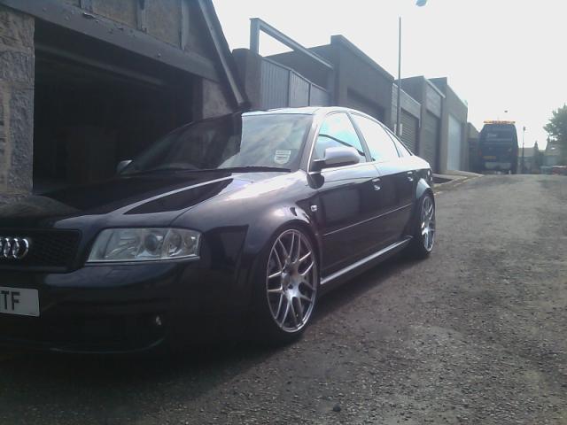

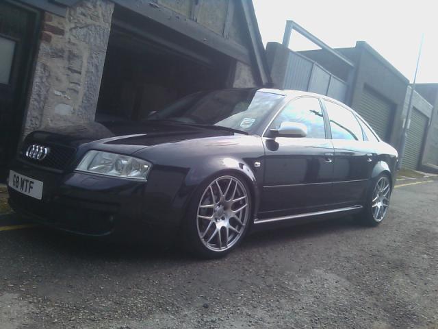

Car is booked in for the DRC/Bilstien change out and discs all round....I'm off to Baku for a couple of weeks...so all will be done for my return.Will post my impressions of the PSS set up in a couple of weeks....
Re: Inevitable
Bilsteins fitted and car lowered........what a difference...PSS set up is not too harsh and the car is a whole lot more planted...would recommend them as a great replacement and at £844 didn't break the bank.
One thing I have noticed is I'm getting a bit of vibration thru the brake pedal when sitting in traffic....goes if you put the car in to neutral....may have always been there and just din't notice on the DRC....anyone got any ideas?
I'm just hoping it's not as The Dead Kennedys sang in "Trust your Mechanic"......One things fixed...another falls apart!!
Re: Inevitable
I had this when I put the PSS9 on. It went away when I raised the car from face plant slammed to granddaddy standard height.
Re: Inevitable
She is slammed to the limit.......so yes this is probably the solution....pity....she's getting raised...but not to granddaddy standard...hopfully can find some happy medium.
On the ride I'd say it's on a par with one of my mates Z4's....certainly not crashy but when you hit a pot-hole you know all about it.

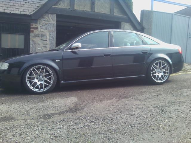

Re: Inevitable
I think you need to raise the fronts a little at least. The front looks lower than the back. This is how mine looked when it was giving me the vibrations:
