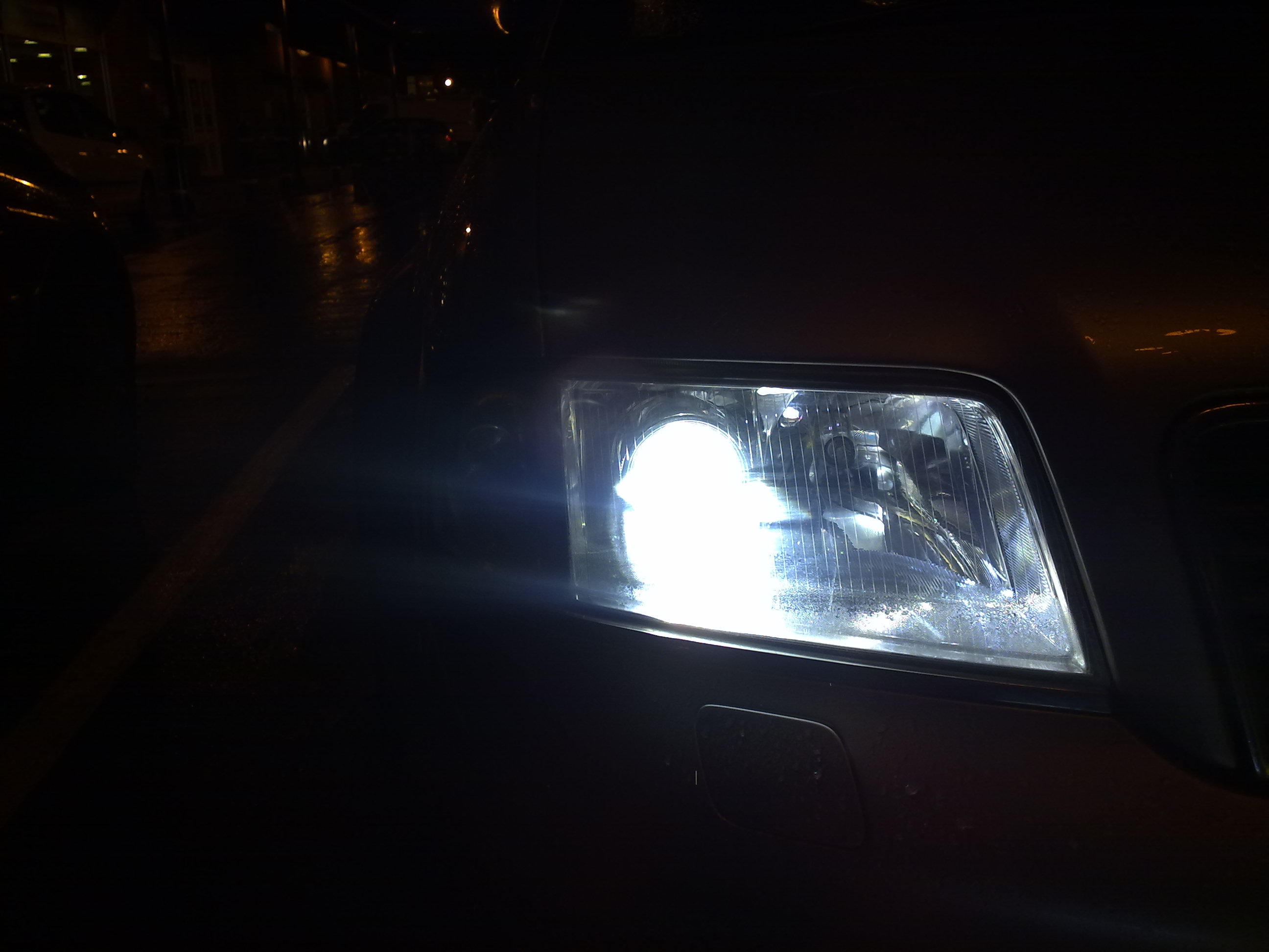

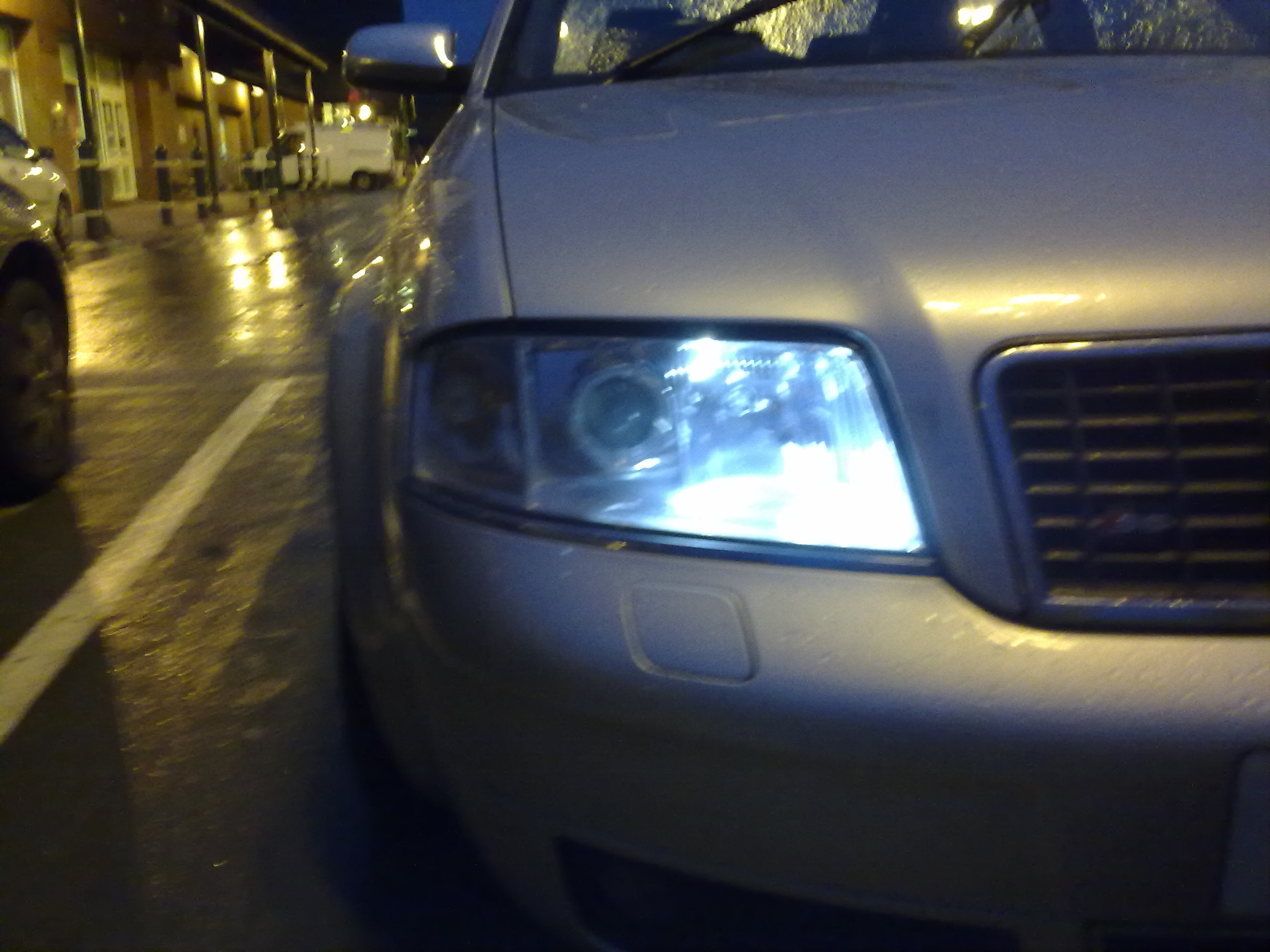

Finally got round to making the enquiry, ordering and fitting the 501 LED's from HIDS4U - http://www.hids4u.co.uk/can-bus-sidelig ... w-led.html - these sidelights are specifically designed for cars with bulb warning and Canbus systems - whatever they are :oops: - so not expecting the failures which have been reported here previously - will report back if they do of course :twisted:
Pics below show firstly with just the LED and then also with the dipped beam on - extremely pleased with the result complements the xenons beautifully.
Just to advise that when I first fitted them, one didn't seem to work so phoned their Customer Service Dept (who as previously experienced were very helpful) and they asked whether I had tried rotating the bulb 180 degrees. I did this and surprise surprise it worked! Don't know why this makes a diffiernce but worth bearing in mind when fitting these before complaining about faulty goods.

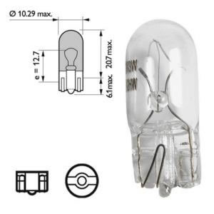

They are just 501 sidelight bulbs. Halfrauds will have thousands in stock.
