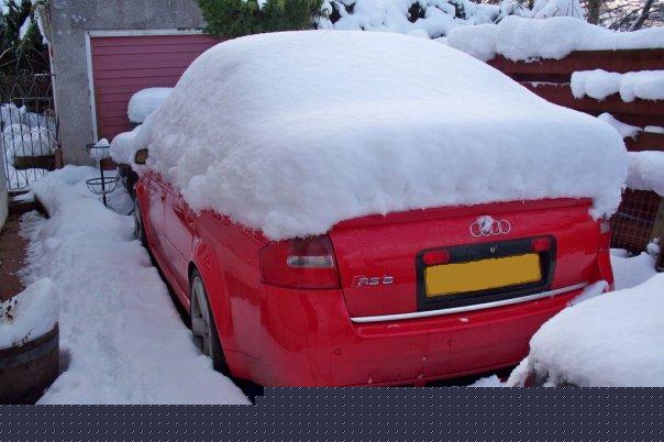

Oh this is what i came home too after being away at work over christmas!

PS - that room in front of the car with the pink door is called a "garage" - the idea is you put the car in to avoid that nasty white stuff spoiling your car!!!! :oops:

nice colour! my fav (along with Daytona + optics)

PS, thanks for the ps but its not my garage, i leave the car at my parents when im away for safe keping :)
