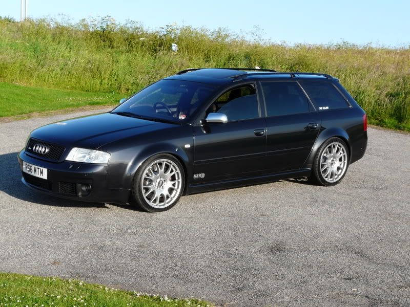

RS_Sex
Posts: 5
Joined: Sun Jun 10, 2007 1:44 am
Post by RS_Sex » Mon Jul 21, 2008 4:47 am
mine sits low too

Post by MoRS6+ » Mon Jul 21, 2008 11:55 am
Holy mackerel! How do you negotiate speed-bumps!? Or ANY bumps for that matter!
