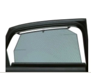

Post by GardinerG » Thu Aug 30, 2007 3:54 pm
Fen wrote: So the blinds you fitted are genuine Audi, Grant?
Here's a pic...
G

Thanks Grant. I assume there is a rear side blind option for the Avant also, otherwise there would be a gap!

Sorry but there's no such option (that I am aware of at least - nor in ETKA). I think it will be a DIY job ;-)

There must be a flush fit option even if it means replacing the door cards. On my B7 RS4, I have side blinds and they fit flush into the door card. Great on hot days and when keeping the sun off the kids.
There is. Adam had them on his RS6. 4B9 861 333 and 4B9 861 334. Part of option 3Y3. You would also require a number of aditional parts, including the interior door pannels - 4B5 867 303 (304, 305, etc depending on colour and side).
Refer to 867-40 and 861-00 in ETKA for more info, if you need all the part numbers I can provide them.
