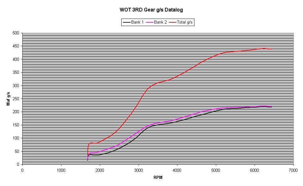

Hi,
Just had my car remapped and logged the new total g/s at 442 and was wondering if this is useful to determine approx HP/Torque or does this form of calculation have too many variables?

yes it's useful :rocker:
what seems strange to me is that my stock RS6 gives 370g/s per bank so a total of 740g/s which is not similar to yours :audibash:

Supercopa - 370 g/s per bank? Mine in stock form was around 360-380 g/s total.

what do you call "total" ??? On my VAG-COM I get 370g/s on Bank 1 window and 370g/s on Bank 2 window when reading the MAF Block.

Supercopa - I call total the sum of MB002 Bank1 and Bank2 in MB003 Vag-com doesnt read over 370g/s. I am not sure how your car gets 370g/s per bank?

ok I read around 370 in MB002 (G70 Bank1] and around 370 in MB002 (G246 Bank2), I've never checked in MB003 the G70+G246 sum.

Supercopa - Um can you post a log? I am 100% that a standard RS6 only reads 360-380g/s I think you are mixing something up as the rule of thumb is total g/s is 80% of your power so if you are logging 740 g/s you have 925hp or a Buggatti Veyron slightly down on power.

ok i'll try, you must be right, I have never checked the sum in MB003 as I said before.
