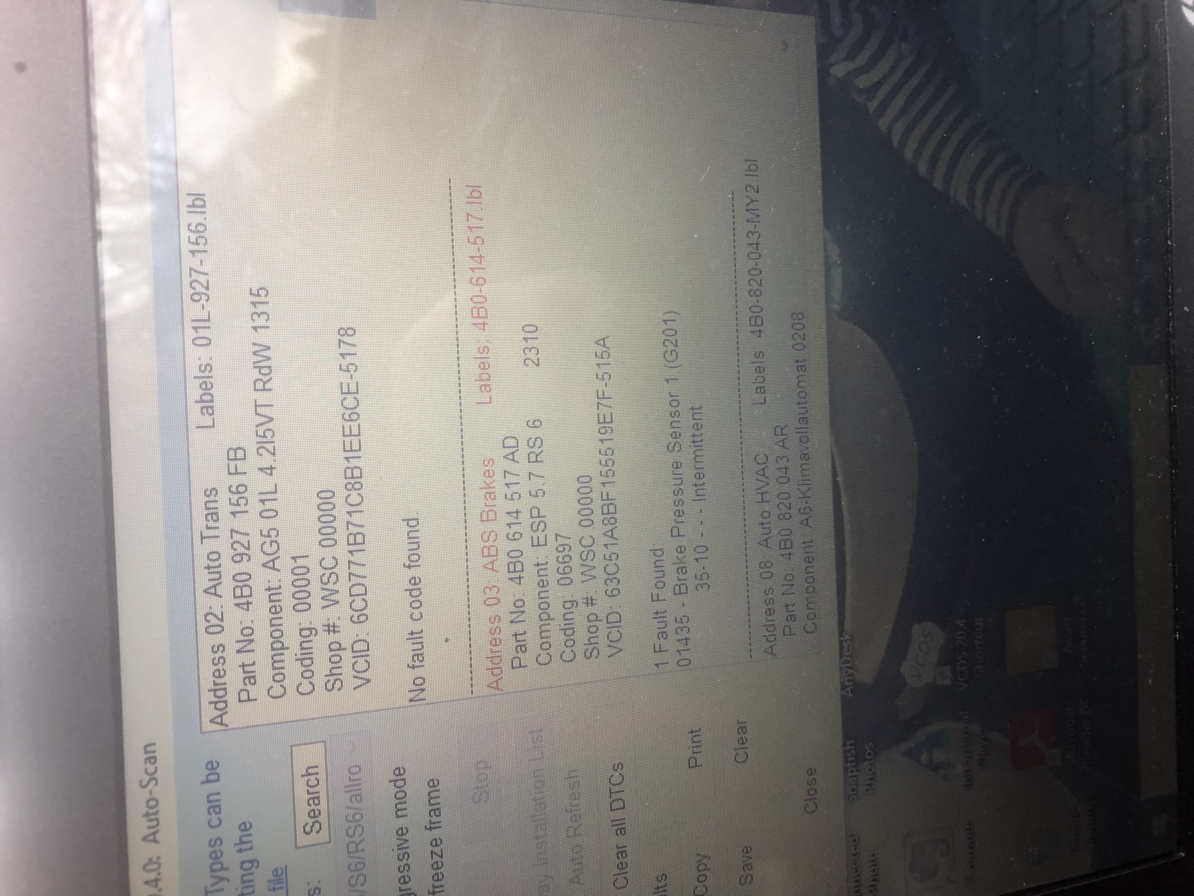

I’ve done a scan and the following error is logged. I’ve cleared the fault but it does pop back on straight away.
Any ideas gratefully received. 👍
Posts: 20309
Re: Brake pressure sensor
Post by Shoppinit » Sat Dec 05, 2020 4:57 pm
Best case, the brake switch is faulty. Check it with the Vagcom. Another good case, the wires have popped off the pressure sender on the ABS pump.
Worst case the impact ripped a tiny gold pube wire off the ABS module circuit board.

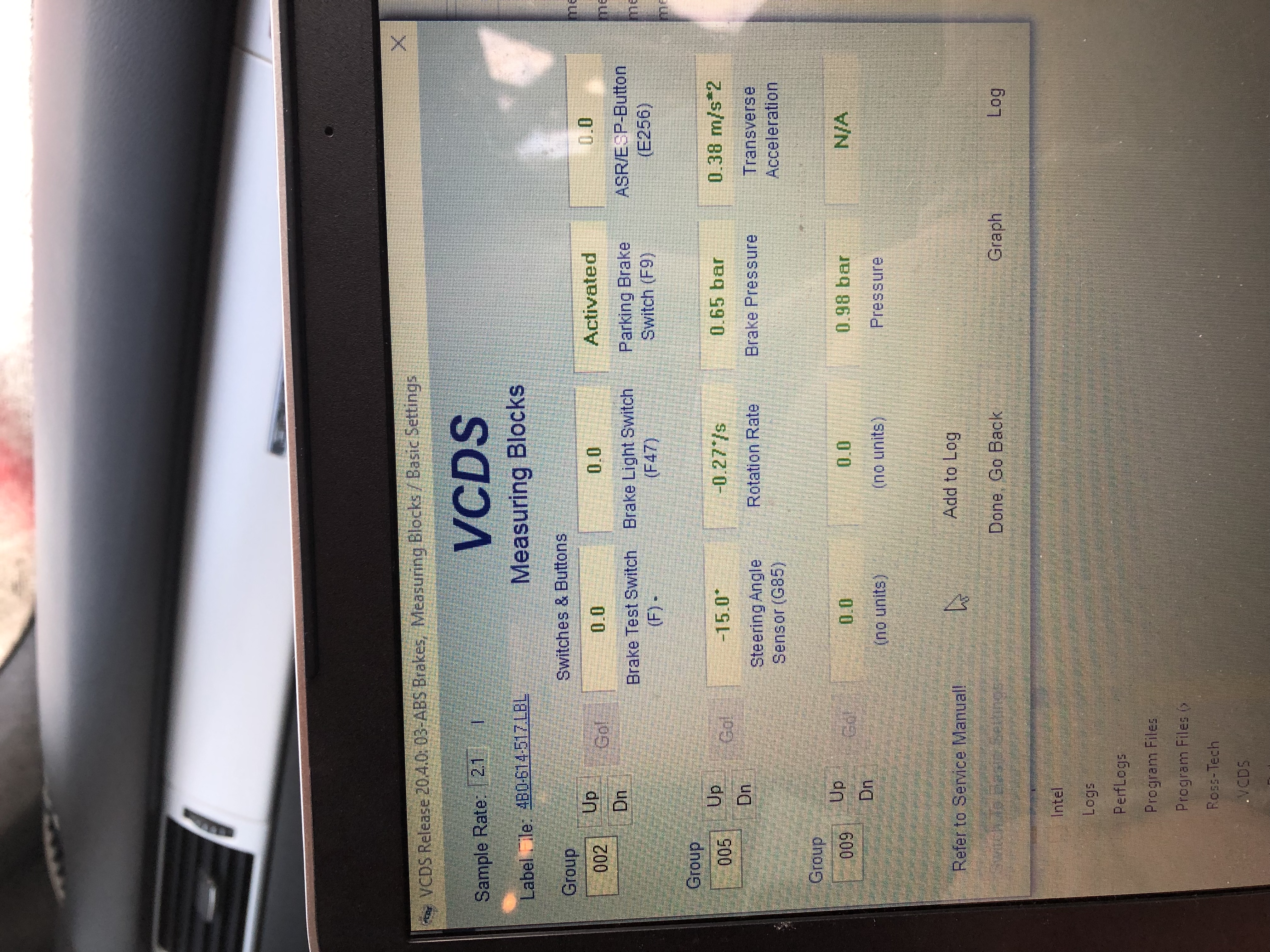

So I’ve had a look with VCDS on groups 2,5 and 9.
On group 2 brake test and light switch both activate when I press the brake pedal and parking deactivates when I release the hand brake. The only bit that looks a bit strange on this group is that ASR/ESP won’t stay activated. It does activate when I press the button but won’t stay on. I’m assuming this is because I’m in test mode rather than it being an issue?
Group 5 has a resting brake pressure of 0.00-0.65 bar. This increases to around 130 bar when I stand on the brake (when parked obviously).
Group 9 also has a pressure reading that stays in line with group 5 reading. It also has two other reading that activate when I press the brake pedal but no units are give.
I’ve also taken a look at the ABS pump but can’t see any obvious issues.

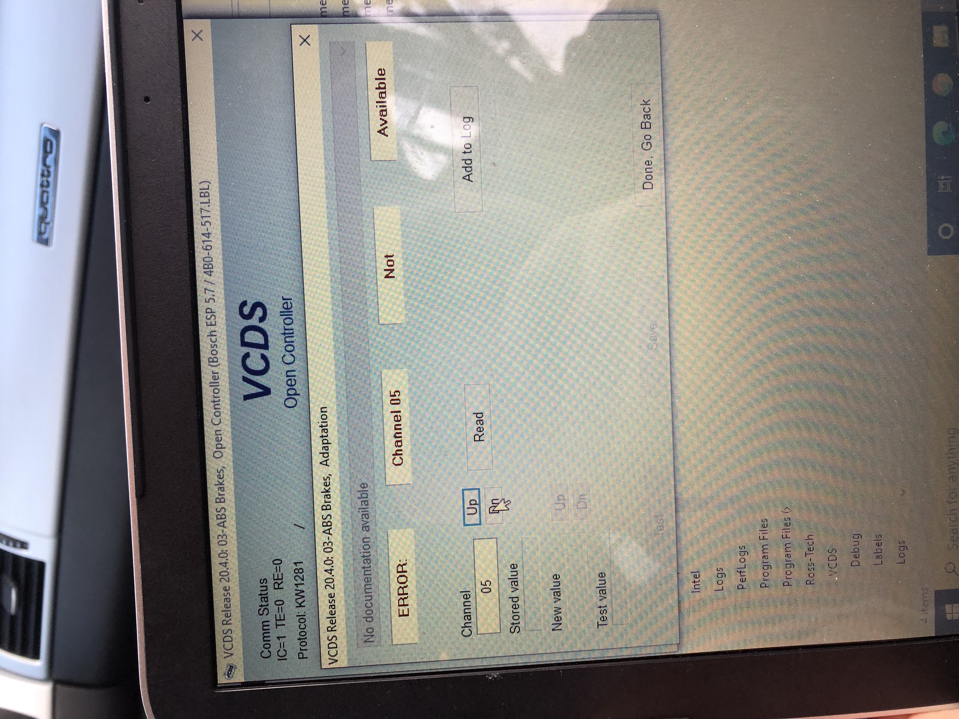

I’ve had a look at the “Adaptation-10” folder but it doesn’t seem to have anything available on any “Channel”.
Posts: 20309
Post by Shoppinit » Mon Dec 07, 2020 12:26 pm
Yeah, there's no adaptation channels on the Bosch 5.7 ABS module.

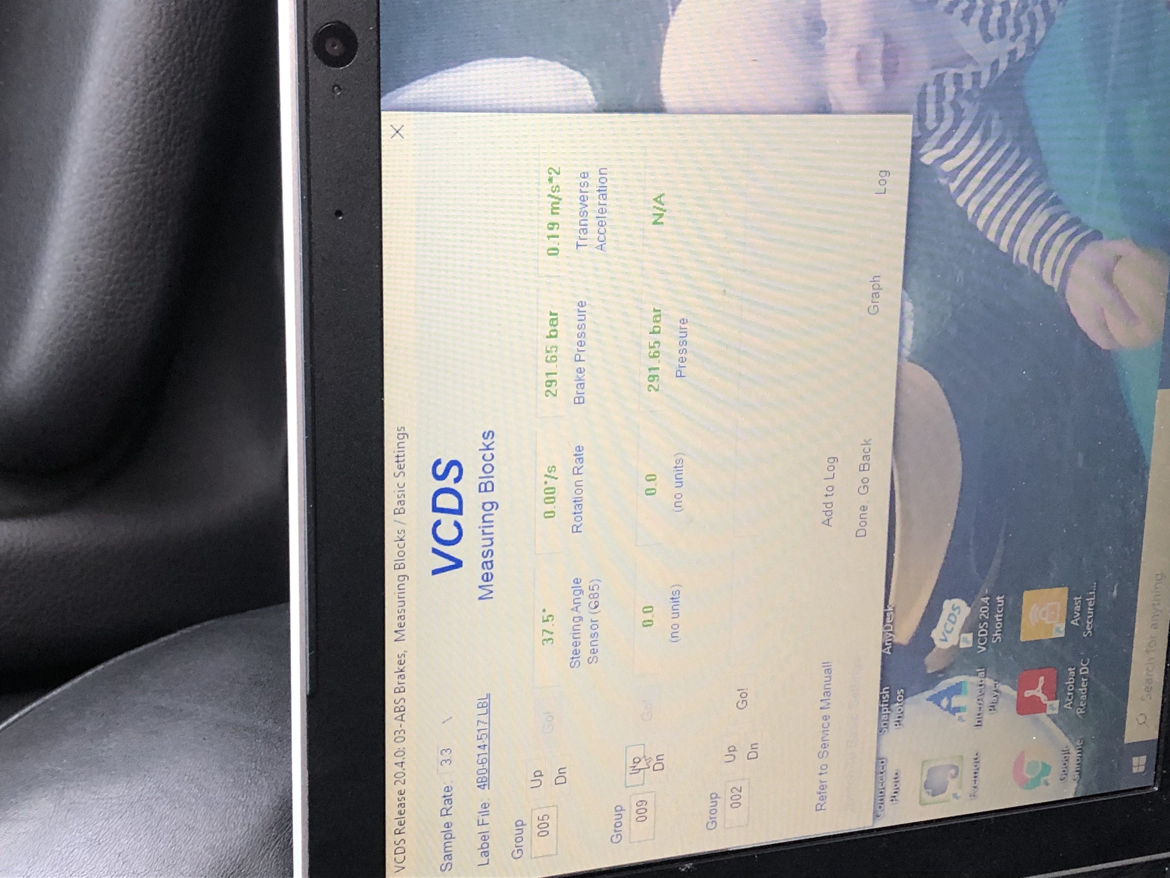

So I fired up the measuring block again for group 5 and 9. Now they’re both reading 291bar, the brakes aren’t on and the pressure reading is constant weather I’m the engine is on of off, driving or not.
Posts: 20309
Post by Shoppinit » Mon Dec 07, 2020 3:24 pm
Yeah, 291bar can't be good. That's why it's putting a code on. It's an incoherent value.
I fear that your ABS module is borked.

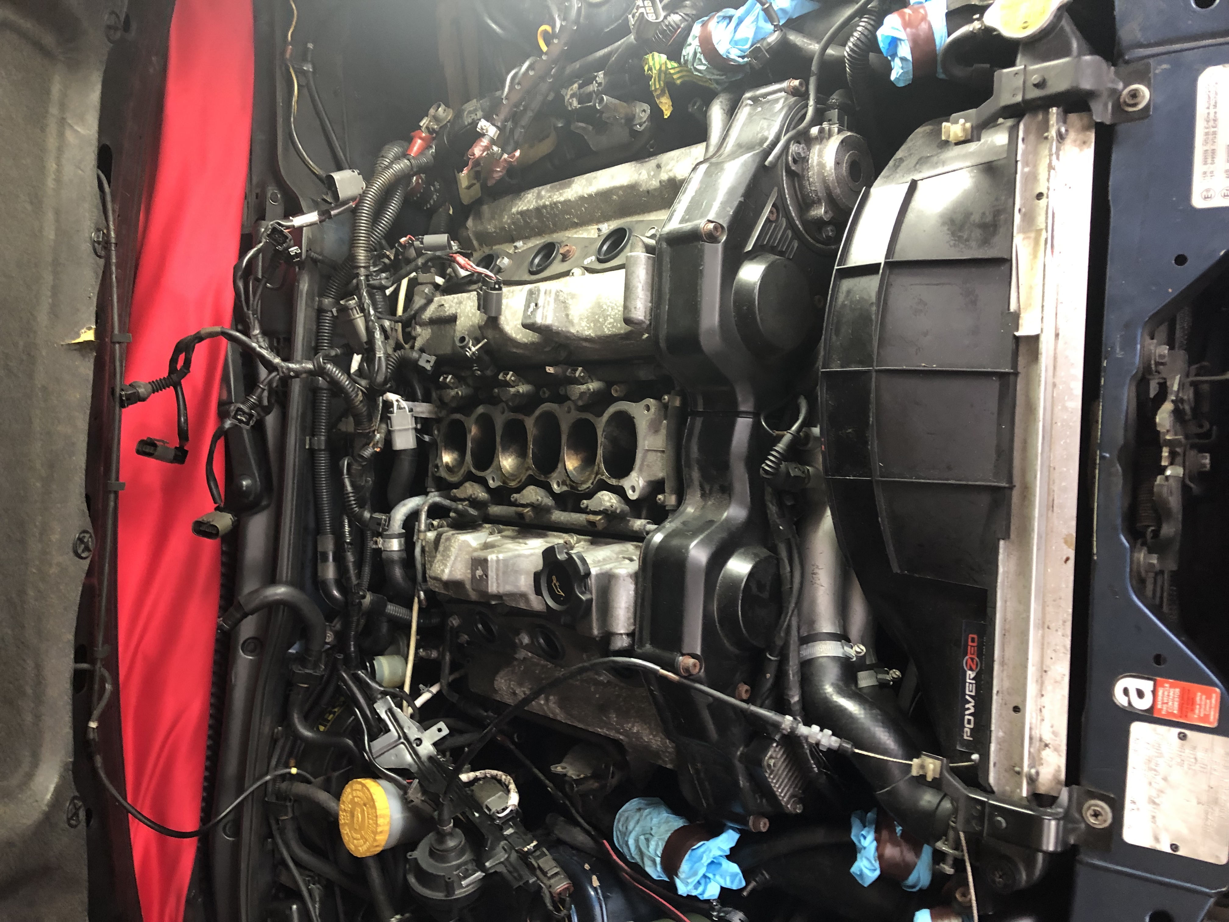

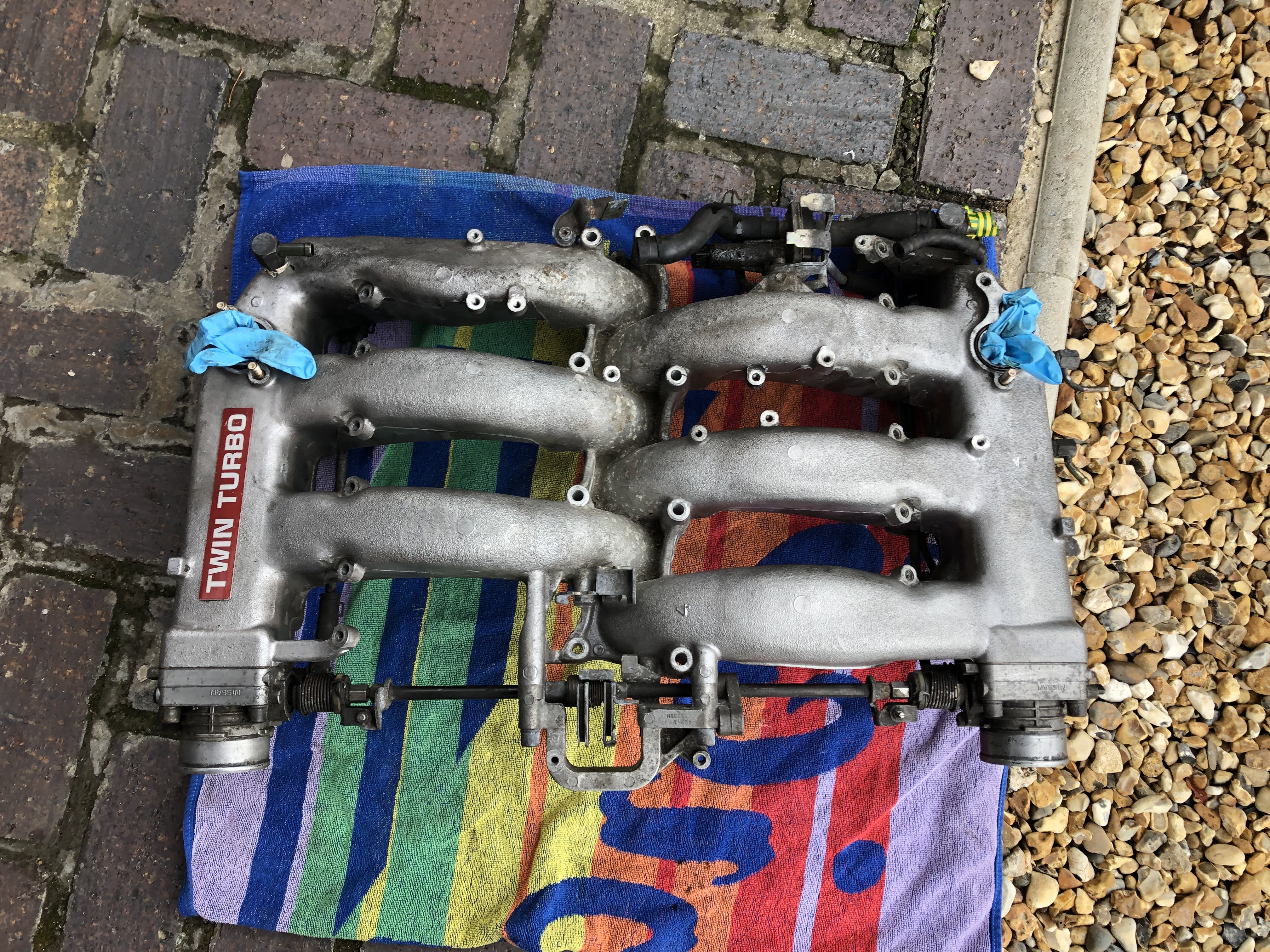

The 300zx is looking anything but simple. I finally got the plenum off after about 8 hours. It looks like, ontop of replacing all the injectors, I’ve got a lot of brittle hoses to replace and could really do with replacing the main harness. Can get the early style harness any more so I’ll need to upgrade the CAS and PTU. 🤢🤮🤑

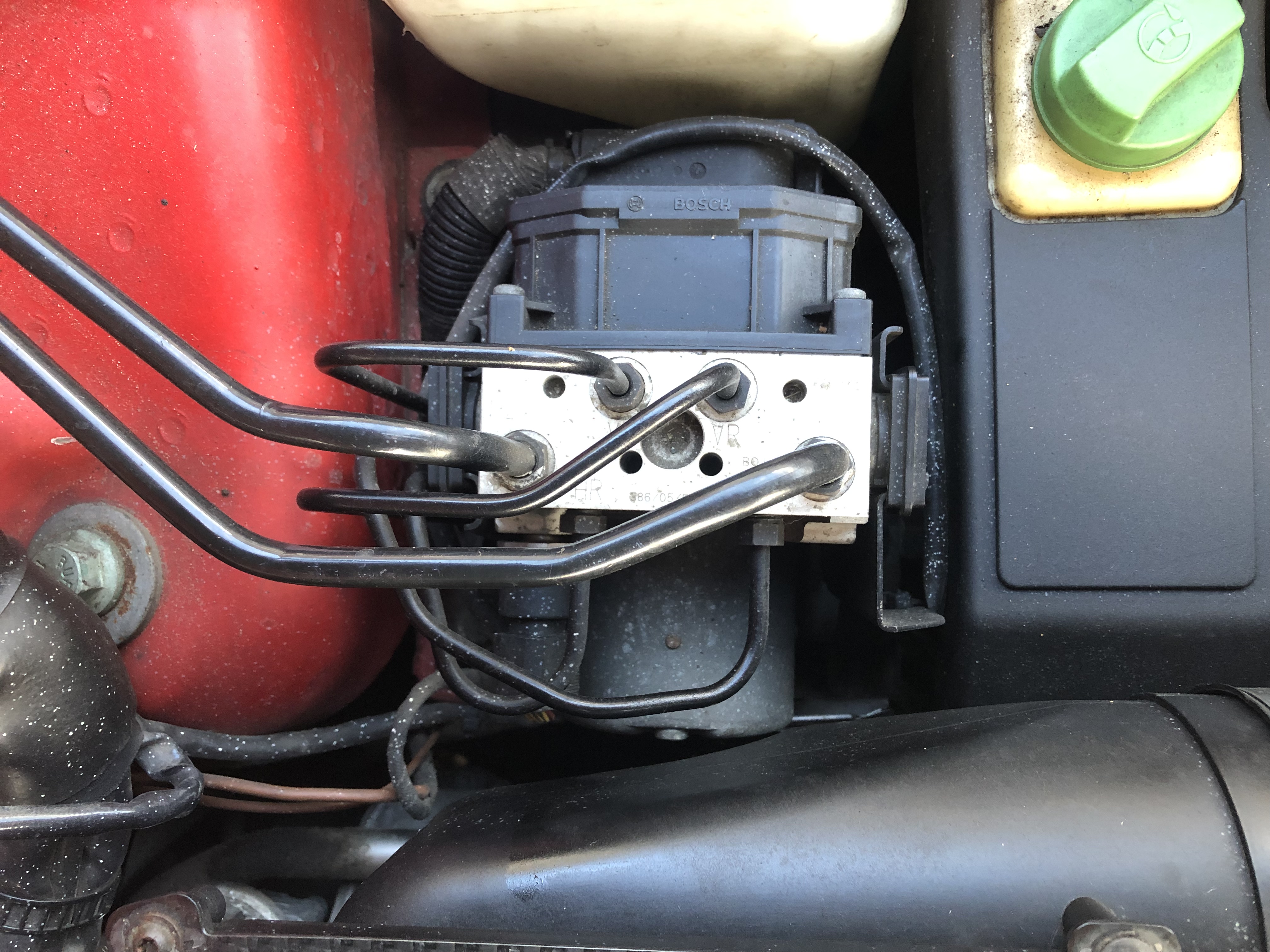

Am I missing something painfully obvious here? I’ve disconnected the two electrical connections and the two retaining clips yet I still can’t bring the unit up enough to access the 6 torx screws to separate the module from the ABS unit. What with the pipe work on top of the unit going off in all directions it seems like you would have to put a lot of stress on these pipes to make it move.
I think removing the wheel and arch liner would give enough access to the lower two torx to get the module separated from the unit.

I know this'll sound weird, but look at those lovely long runners into the plenum. Good design.
