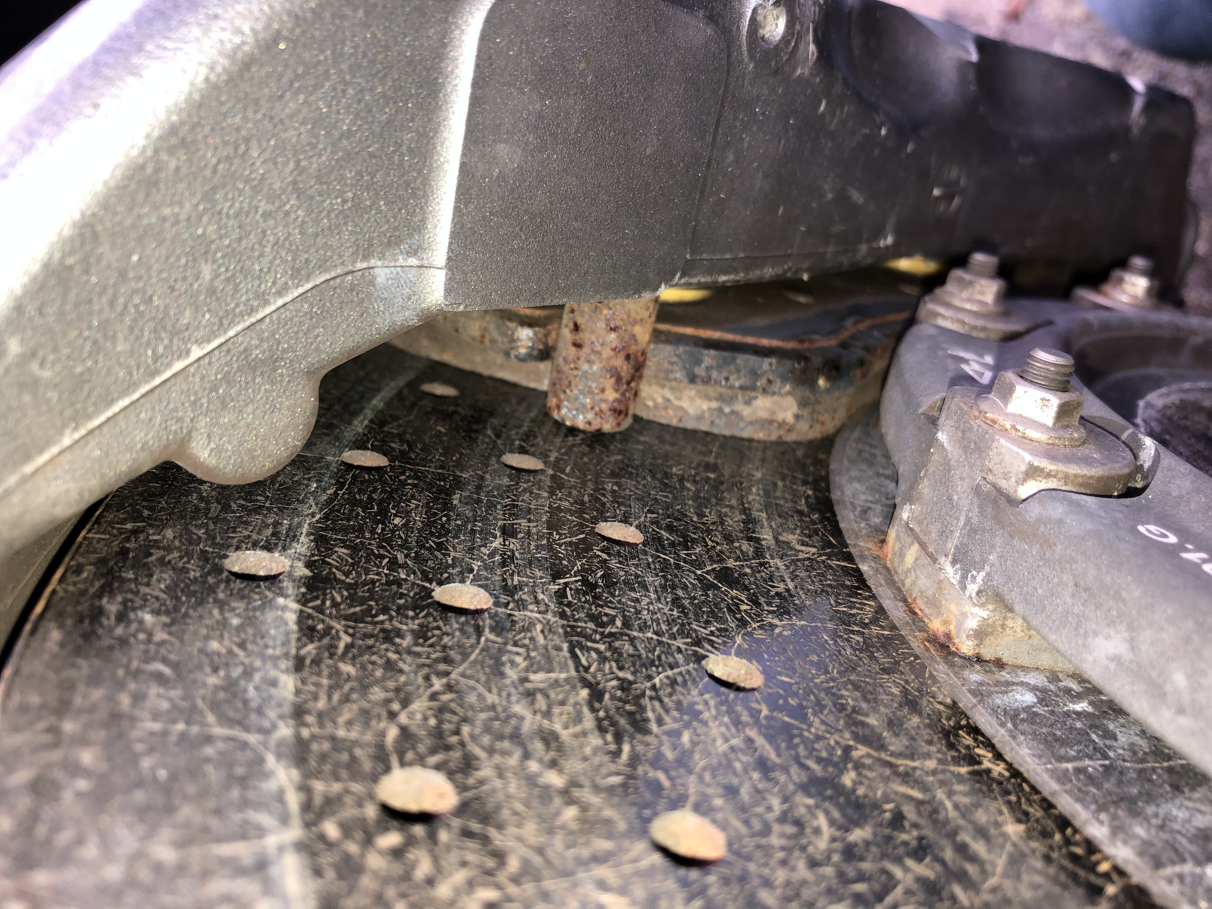

The discs look a bit crazed, is that kinda normal? It’s only done 38000 miles. It’s been off the road for a long while as the guy worked offshore. Not sure what to expect as never owned a car with ceramics 🤷‍♂️

Saying that, I've certainly seen crazing on other ceramic discs and it's pretty normal. Take a browse through google and you'll find forum entries on this from Porsche, Lambo etc. Most stuff I have read is that this is normal and the cracks are only microns deep and nothing to worry about. I read somewhere that when Lamborghini moved the production of their ceramics to Germany this crazing became common (especially around the drill holes - which seems to be the case in your pic). It's just a consequence of the manufacturing process and nothing to worry about is what I read.

I get chance to play with two F type Jags with ceramics at work , and they look similar to yours.

Wear rate looks fine. I think some harsh chemicals have been used a fair bit on them, from looking at the rusty pad carrier and disc bobbins. I'd try to avoid spraying any wheel cleaners/fallout removers/strong APC solutions on to any disc and calliper for this reason alone.
