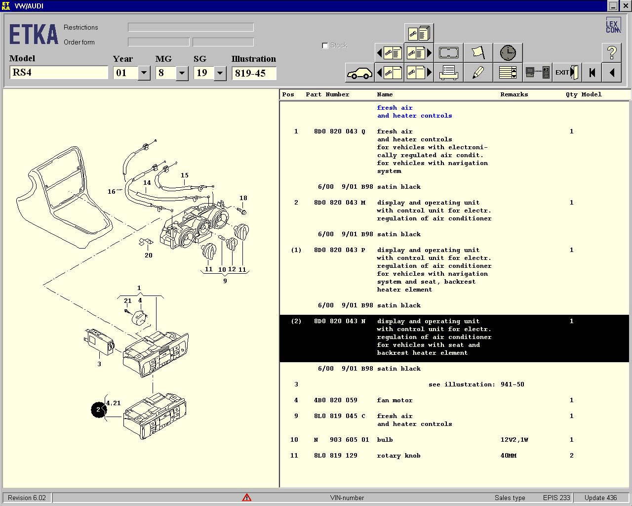

Hi Folks,
I am working away from home and don't have my parts catalogue with me so I am hoping someone can confirm if the following Climate Control unit is a Double Din arrangement compatible unit.
8D0820043N
Many thanks in advance
Dazzer

Which model/year?

Well I am looking to buy it for my S4 99FL for a sat nav upgrade.

Post by Peakz » Tue Jun 26, 2007 9:18 pm
Found this on ETKA

Thanks Peakz - safe to say it's not suitable :cry:
Cheers for a quick response
Dazzer

what the different between 8D0820043N and 8D0820043P????
If my b5 RS4 2001 would like to upgrade to RNS-E, which one should i get???
thanks
