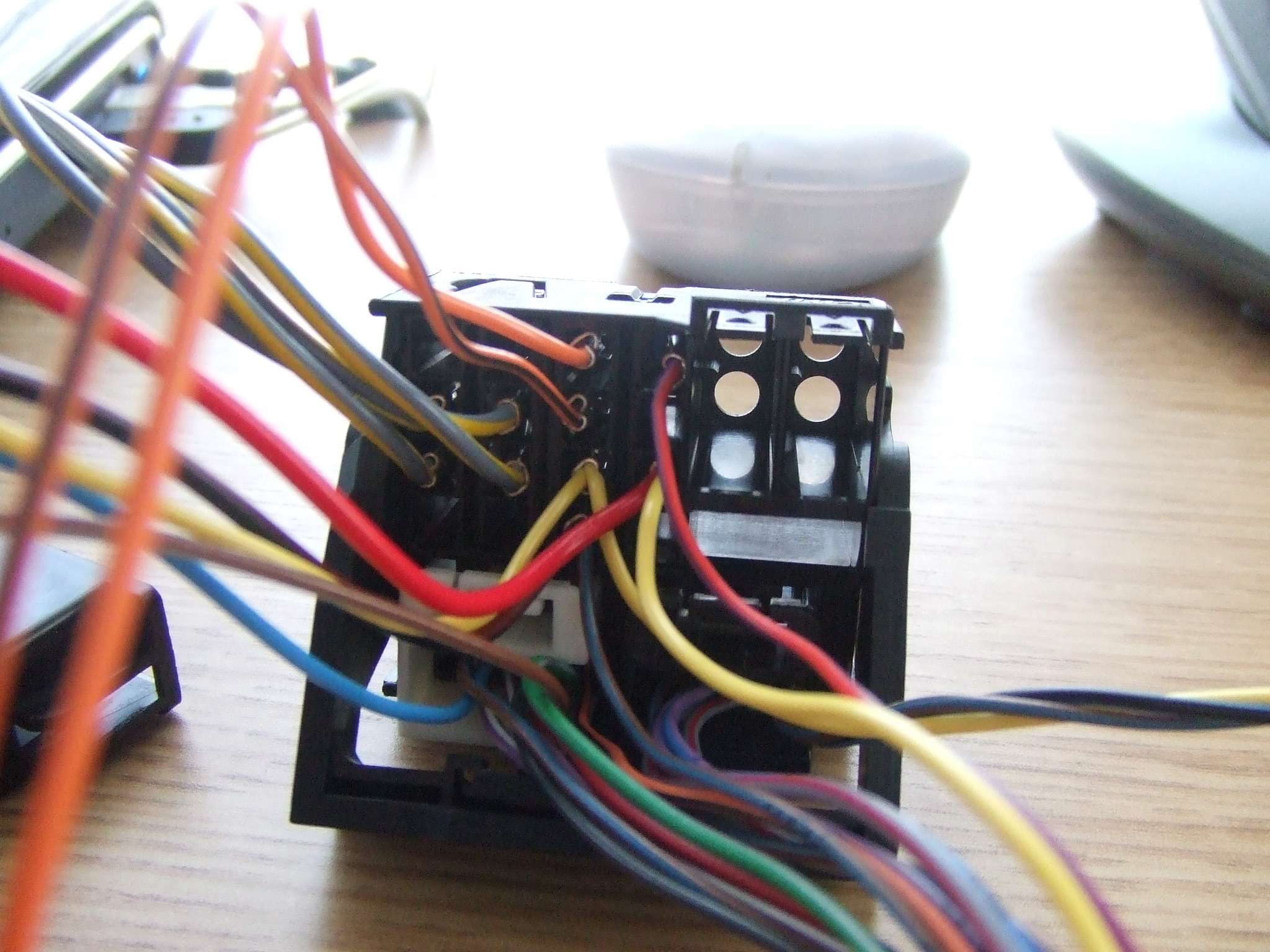

Post by quatt » Sun Jun 10, 2007 5:57 pm
here are the pics of the plug n play connector
quatt
Posts: 13
Joined: Sun Jun 10, 2007 1:38 pm
Post by quatt » Sun Jun 10, 2007 5:59 pm
i have checked and there is nothing in d16, and d13 is red lead with a thin purple stripe down it... i,ll upload some photos if that helps

PetrolDave
Posts: 7599
Post by PetrolDave » Mon Jun 11, 2007 9:02 am
When I've had this problem I've found the quickest way is to check where EVERY wire runs between the Quadlock connector for the RNS-E and the other connectors that connect to the car.
I have an Excel spreadsheet which lists the correct routing - if anyone wants a copy PM me.
