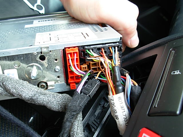

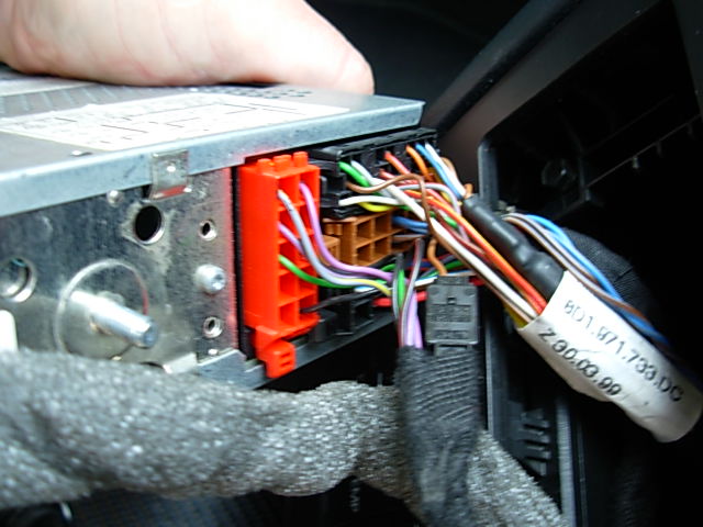

Right i have just checked my radio and have added a photo so anyone got any idea's as to wheather i have can bus?
TIA

No you dont have canbus on the radio, you can clearly see the CLK/DATA/ENABLE on the middle of the 20 pin connector, the 2 empty pins are where CAN should be, pins 7 & 12.
