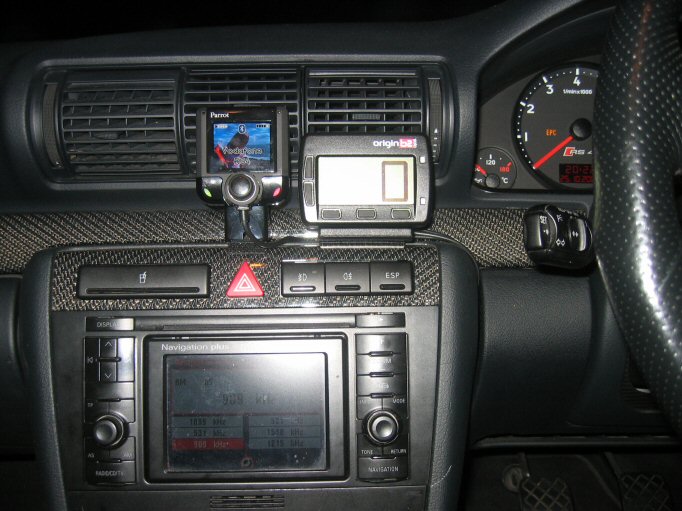

I've got the 3200 LS running through my Navigation Plus Bose system, it mutes and plays through the speakers. Don't know how to wire it in though as it was fitted for me. I know that the company that supplied and fitted it used a special interface for the Bose system, and that cost extra. If you really get stuck, you could try calling the company that fitted mine, AVR Mobiles, they were very good.
We've fitted a few Parrot kits to cars at work and some of the screens were dead, which apparently isn't unusual, so keep an eye out for that.

No probs, glad it was of some help. Did you resolve your collateral damage starting issue? Don't forget to post a photo of your stealth install into the vent. Mine's in front of the vent.
Mike
