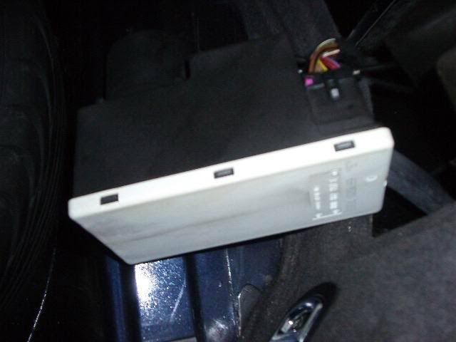

beeps from the boot are one of two things..........
1. coming from the pager belonging to the dead hooker in the boot
2. coming from the alarm in the right hand side well in the boot
unless your name is Drexl and you look like Gary Oldman i'm guessing it's 2

that's the control unit for the alarm and central locking, the alarm sounder that contains the battery is just aft of that bolted to the edge of the well
