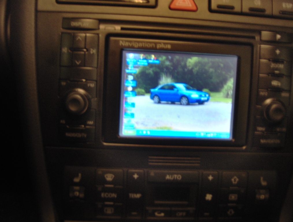

Digital TV?
Digital TV and much, much more...

RE: Digital TV?
Ok, here's the status of our little project. Today we installed a micro ITX pc into the boot of Clives S4 connected through the TV Tuner using the S-video and sound cables so now we have a mobile digital media player capable of playback of movies and sound through the Nav-Plus unit. the only limitations on the amount of music etc is the size of the hard drive. we have a small issue with getting the PC to start to boot when we operate the remote control to unlock the central locking but that'll be resolved next weekend with the addition of a 12v solid state relay. at the moment we've just played music and movies but we envisige adding a Wi-Fi dongle to allow updating the media from the home network, a Bluetooth dongle for in-car hands free bluetooth phone, a digital DVB-T usb stick for freeview and a permanent connection to the OBD11 interface via Vag-Com so we can display the boost gauge in Vag-Scope in the Nav unit.
currently we're programming everything through a seperate monitor as the screen isn't really big enough on the Nav to be able to navigate effectively but we hope to cure that by installing some custom car pc software. it's all controlled at the moment through a small touchpad attached to the PS2 mouse port. obviously there's still quite a large amount of work to do to complete this but if it all works we think this'll be the ultimate media accessory.
