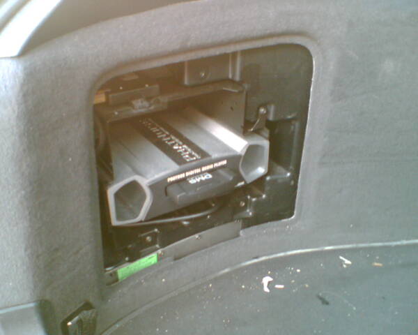

Ok then, i've been into the compartment where the cd changer is and i cannot find or see a way of getting it out??? I can see 2 bolts on the left that bolt the cage to the car and one on the right that looks awkward to get to. Whilst i was in there i noticed what looks like it could be an amp on the right hand side??? Any help would be appreciated. I dont want to buy the phatnoise until i know whats what.
Thanks.
Thanks.
Hi Duane,
Although I've an RS4 (Avant) the swap should be pretty much the same - I just removed the 6-stacker unit from the cradle in the boot and slotted the PhatBox in.
All I had to do was remove the cradle (3 screws in this case) and then undo the screws that held the Phatbox in the cradle. Might be slightly different in a saloon though.
Picture attached for reference.
Paul
