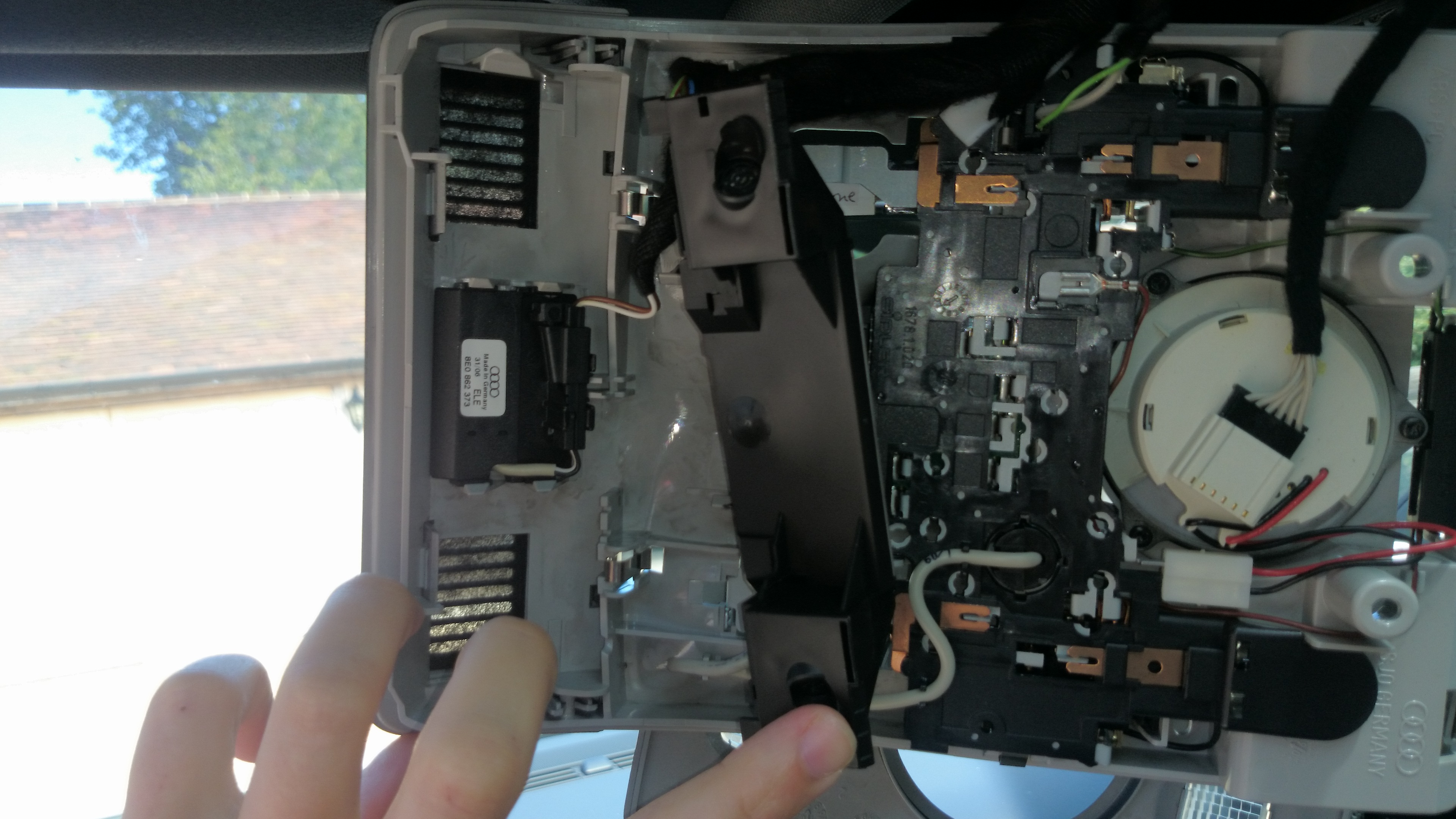

I bought my car knowing that it had previously had the seats stolen, and in doing so the interior light panel was also ripped out.
I've taken the current panel off (see picture) and it appears that the mic hasn't been replaced - there's a brown wire and a white wire that have just been taped off.
Is my assumption correct? If so, any advice on a new mic?
Thanks in advance
Mike

Do you have a phone module? They weren't standard fit, it was an option, and no phone module = no microphone (the Bose AudioPilot microphone is visible in your photo but that isn't used for the phone).
Try checking address 77 with VCDS (VAG-COM) to see if there is a phone module.

Your Bose Audio Pilot microphone is still there.
What is missing though is the Alarm movement detector, there are two components but I think they come under one part number - 8E0951177

From reading what you & Dave have been discussing, it also sounds like the roof panel is missing the Bluetooth Microphone which is located on the other side of the panel you've pictured. It is betwixt the sunroof rotary controller and the main interior light switch, the mic will plug into a connector that has two wires 1) green 2) white/transparent.
Have a look in this thread to see what we mean - viewtopic.php?f=35&t=59893

Hmmm, interesting...
The only wires I could imagine being for the mic are brown & white. It looks like the connector has been cut off them.
I don't have a sunroof so would think that the unattached connector in the photo would be for that...
I'll also pick up a replacement mic and see how we get on..

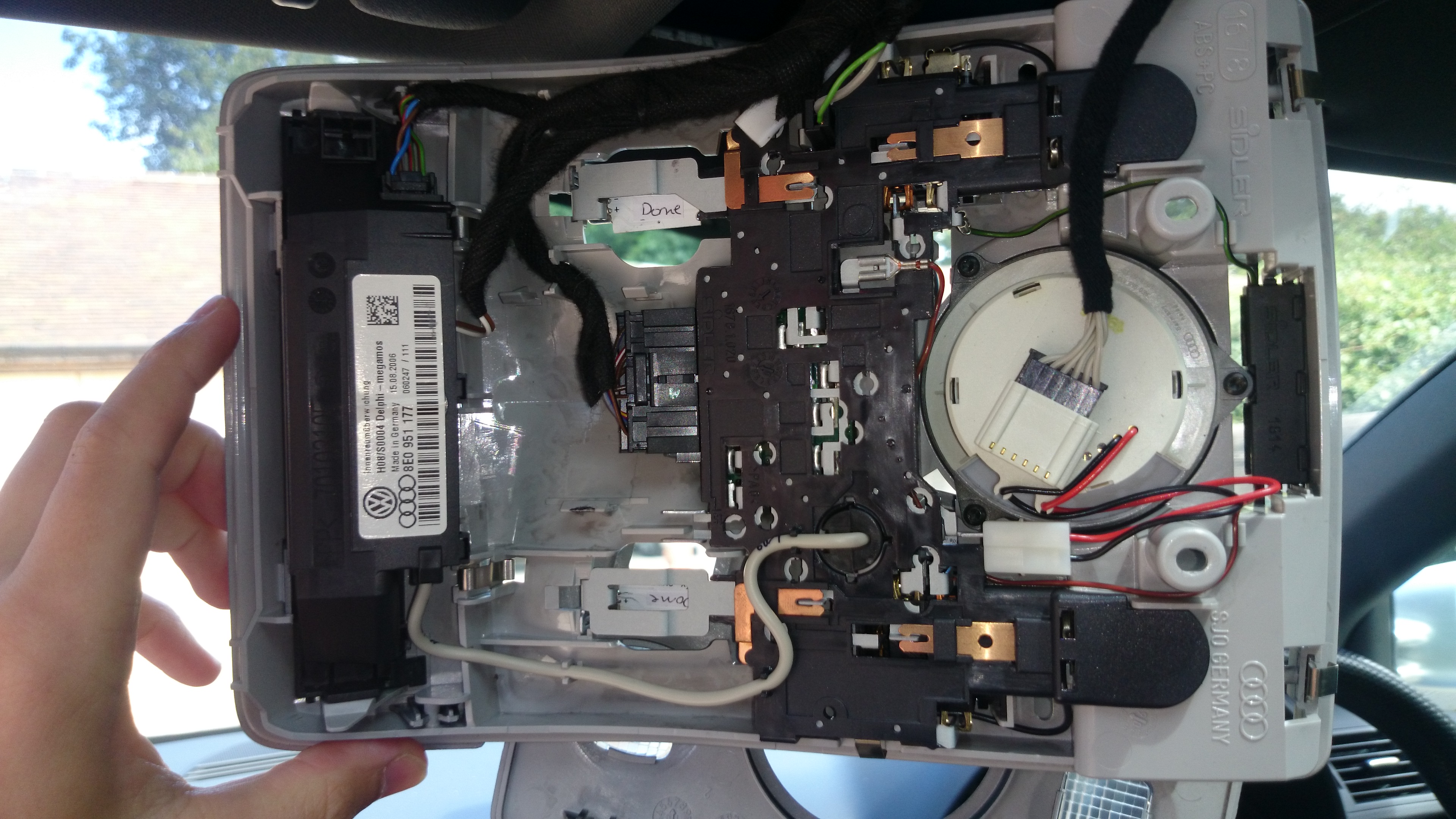

Mike,
Appologies, I got my orientation wrong on the roof unit. Looking at this with fresh eyes today:
Brown and white wires = Bose Audi Pilot microphone (located under the alarm motion sensor).
Blue, Brown, green/red, green wired connector = Alarm motion sensor
Green, clear\white wires = Bluetooth microphone

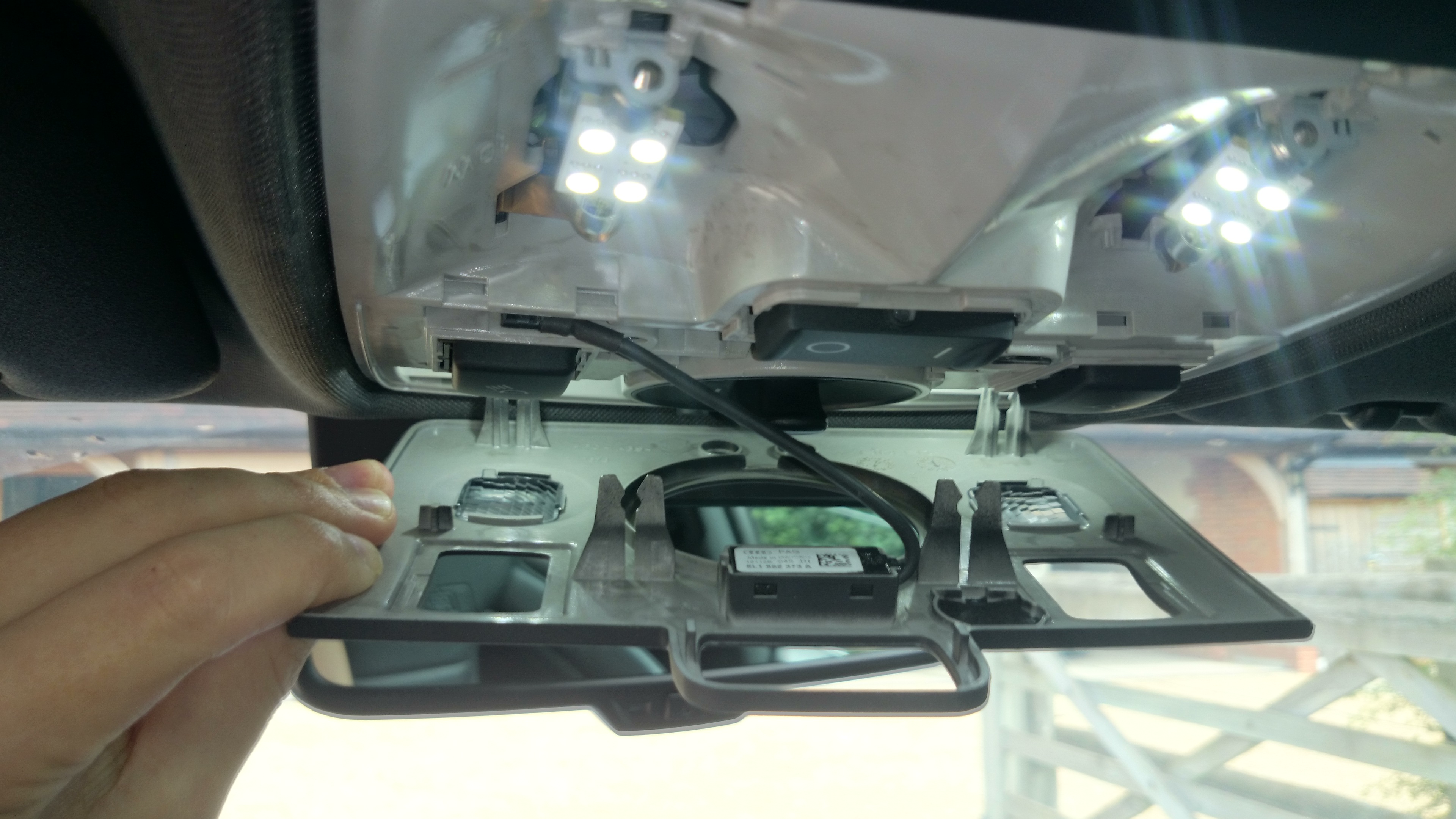

I've attached some pictures from my own car to help you out.

Hi Sam!! Superstar!!
Thanks very much for the photos and the details.
That's cleared everything up now with regards to the wiring so I'm a happy camper

OK, mic all fitted and Bluetooth now working for the phone.
