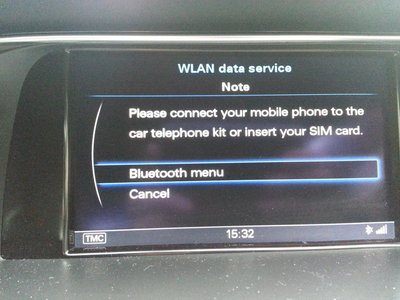

Keep getting this message everytime i connect my Samsung note 2 with wlan to the mmi. the car does not have the plug in phone kit or the sim slot between the sd cards?
From what I can figure out from the manual, I should be able to used the phones data wirelessly, but am having no luck. Phone i paired with bluetooth already. And I am able to play music via Wlan in the car.
any Help much appreciated.

You can see the phone Bluetooth is connected from the photo - bottom right is the signal and Bluetooth indicator.
However it might be a problem with the phone. not all Bluetooth stacks support networking and data.
Try a different phone to test.
Make sure there isn't any access permissions on the phone to set.

Its a samsung galaxy note 2. which should support this. The only other thing I can think of is the car can't 'see' the data as its so bloody slow in this area!
Mark
thanks for the reply.
Mark
