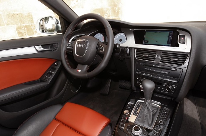

Had another look at steering wheel and it looks like a later S4 or maybe RS4 steering wheel that's been plonked on to it although it has smaller paddles than I'd have expected an S4 or an RS4 to have.
i found this photo of a similar one online, although it feels great in the hand I'm thinking now someone didn't wire it up properly. Is it very messy job changing/adjusting a wheel?
Codes tell me that car was originally fitted with a 2ZS steering wheel which I am guessing was a 4 spoke multifunction one.
Glad that i now have a hobby sourcing all the original parts..........
Will let you know how it all goes.

There's no way it'd be an RS4 wheel with paddles. Popular choices for replacement steering wheels have been TTRS and C6 RS wheels. The problem with both of those options is the dual stage airbag system mated to a single stage system found on the C5 i.e. It won't fire in a prang!
It sounds like the previous car owner would've spent time as a forum member, post your car details, someone might know it or of it. I'm sure it's a nice steering wheel but as mentioned, the real issue is, how safe is it during a crash and how would you 'test' it?

If there is no Airbag light on, the resistance in the airbag is ok.
It should still fire in an accident. The airbag control unit will send a deployment voltage anyhow.
The two stage part of it means it has two igniters that fire between 5 and 40ms apart dependant on impact severity.
So it should still fire the main charge.

Hmm, no airbag light on so that's reassuring especially after it had occurred to me that airbag might not be working.
Yeah, the RS4s were all manual, right? Guess that'd mean no paddles on their steering wheels.........
So think it's just bad wiring by previous owner who put it on there? Will reset radio first and see if that makes any difference then take it from there.
Thanks for the insights then reassurance.
