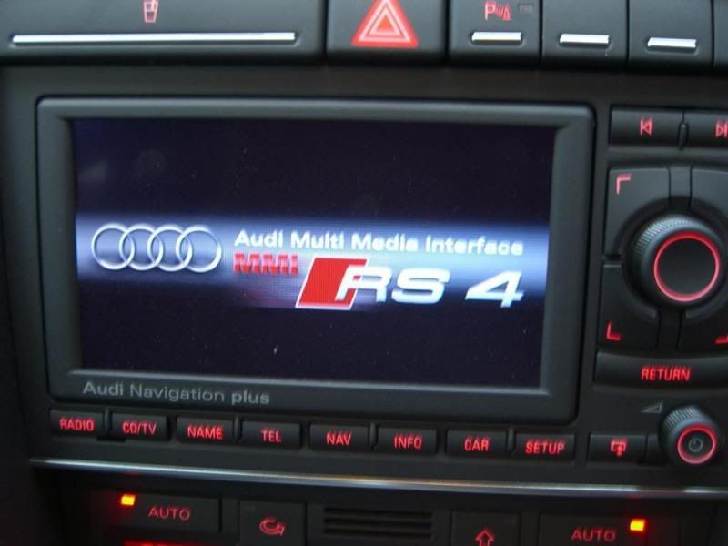

PetrolDave wrote:With acknowledgement to Dirk on http://www.navplus.us and to the Ross Tech wiki http://wiki.ross-tech.com/index.php/Aud ... art_Screen
Here's how to change the startup screen on your RNS-E to match your car - It appears to work only with SW 0500 or later (nice to have the RS4 startup screen now!).
The value in Adaptation Channel 018 controls the Startup Screen:
0 = Standard Start Screen
1 = Audi S3 Start Screen
2 = Audi S4 Start Screen
3 = Audi RS4 Start Screen
4 = Audi TT Start Screen
Please note that after changing the startup screen you will need to reboot the RNS-E (save a value of 1 in Adaptation Channel 111 or hold RADIO and SETUP until it reboots).
On my car it only goes up to Chanel 99!
