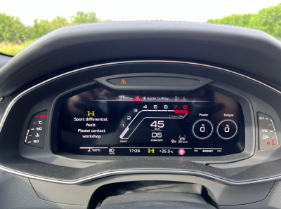

Today (after waiting over a year) I went to go pick up my brand new Audi RS6. I took delivery of the car. Everything looked good, all the paperwork was signed, and I left the dealership to take the car back home. 35 km on the odometer at this point.
I left the dealership in RS2 mode, because the salesman was showing me how to open the valves on the exhaust. Barely touching the throttle I eased my way out of the dealership, took a left hand turn and way before reaching even the first traffic light (less than 40 meters), the car displayed a warning "Sport differential: fault. Please contact workshop"... great. The car didn't even make it to the first traffic light. I do a U-turn before the light and take it straight back to the dealership. I turn off the engine and I find the salesman that took care of me during the delivery. Salesman goes and gets a mechanic. After turning the car on again, the error code is gone, but we take it to the mechanic who turns out to be their main diagnostics guy as well. They put the car on a lift and check the underside of the car, read the codes, and check the sports differential. The diagnostic software called for the issue to be either A) Due to excessive wear caused by overloading the diff with aggressive driving or B) A harness/cable issue. The diagnostic guy said, the code is not present at the moment (since turning the car on again), so he will just clear the code from the car's memory (as there are no cable issues).
Meanwhile the salesman confesses: "oh by the way, when I took it out to put a few liters of fuel in the car for you earlier, it gave me this same code, so we checked it out with a different mechanic guy and he said a delivery service step was improperly done and that is what caused the error, so we just reset it." I was unaware of this up until this point... great. So the mechanic/diagnostic guy says everything should be fine from here on out. I tell both the mechanic and the salesman that I want my delivery documentation to include both the fact that the salesman already had this code once and that I got it 40 meters into owning this car... we amend the delivery documents and I get a printed sheet of the diagnostics.
Thinking all should be good from here on, I leave the dealership to go get the car fueled. At this point the car has 60km worth of fuel in it.The drive to the nearest gas station was around 2.5 km away. No issues and I believe I selected RS2 mode, just to test under the same conditions, but drove it as easy as possible - very very light throttle inputs (due to the break-in period). After fueling the car, it was time to head back home, so I headed for the highway. In approximately 4 kms, just after a roundabout the car displays a warning message: "Sport differential: fault. Please contact workshop". Because I just entered a closed 2 lane highway entry road, I had to take a longer route back to the dealership (approx. 7.5km) while driving 30 km/h - changed it to comfort mode (the car did not enter limp mode, but I wanted to be safe by putting as little stress on the main components as possible). There was no noise, no rubbing sounds, no detectable handling changes either. However, the error code was still there. I call the dealership, this is past 5 PM, so EVERYONE is gone. They tell me well, they can't do anything about it now, so I would have to leave the car there at the dealership and we would deal with it tomorrow. Great delivery experience to say the least.
So now my (100K+ EUR brand new) car is sat on the the lot with 49 KMs on the odometer with some Sports differential fault. Within this 49 kms the car has presented the same issue 3 times already.
Going back tomorrow and trying to figure out next steps. Any tips or experience would be greatly appreciated!

DAY 2 - Diagnosing the problem
Day 2
Went back today to dealership to figure out what was wrong with the car. Diagnostics were ran on the car again and the car was placed on a lift. The diagnostics seemed to return the same wiring issue and then also an oil pressure inconsistency issue. So, the decision was made that we should start eliminating potential faults: starting with the wiring itself, then the computer that controls the differential, then the sensors, and finally the differential pump itself. The wiring was checked from underneath the car, it seemed fine, but then the whole cable run had to checked. To do this, the entire cargo area had to be torn open to reveal the differential computer and the end of the wire harness. The wires were all checked and everything was as it should be. The wires were out of the question. After further diagnostics, it was established that both relevant sensors were sending data to the computer and the computer was executing the necessary commands towards the pump itself; therefore, the computer was also deemed as being in order.
The next step is changing the differential pump and differential oil. Parts will arrive over the weekend. Will be updating early next week.
Wish me luck.
Wish me luck.

DAY 3 - No joy
So today, I got to the dealership around 11:30. The plan was to change both sensors, the oil pump, and the oil for the sport differential. The factory oil was clean as it could be - no sign of any contamination or foreign debris. Turns out, you can only change the sensors 1-by-1 otherwise, some calibration will get messed up. So we first tried changing the upper sensor, which is the black plug sensor. This alone and changing the pump and the oil didn't resolve the issue, so they we ahead and changed the second brown connector sensor as well.
Unfortunately, this didn't resolve the problem either. When running the diagnostics, it seems that the sport differential test will fail at first, but past consistently on the second try. The initial failure also comes along with pressures around 1.5 bar on each sensor, while the second test results in pressures around 40+ bar (which is what it would need).
Air was removed from the system during all phases; however, right now the car wants the diagnostics to run a basic test, which the car is unable to complete at this point. Therefore, the sport differential code cannot be erased from the vehicle.
Tomorrow, they will be changing the actuators (both of them) of the sport differential. They have submitted logs and requests towards the factory, so that they can assist with handling the issue.
I am still driving a Cupra for the time being. I am getting very inpatient and so far the cargo area in the interior had to be disassembled, the exhaust had to be lowered, and most elements of the sport differential had to be dissembled as well. Not happy about all the work that has to be done on this "new" car. Also, the diagnostics called for the engine to be shutdown and restarted at least 2 dozen times, which is not the most ideal for a 50km engine.
Current car: Audi RS6 C8 '23 (EU spec)
DAY 4 - BIG JOY
Today, I finally drove away with the RS6. The actuators were changed and that immediately resolved all the issues relating to Sport Differential Fault.
So the tl;dr: If there is a Sport Differential issue, start with changing the actuators, even if the diagnostic says its a pump, cabling, or sensor issue. One of the mechanics said that this issue was present in a S8 and another RS6 as well and in both those other cases it was also the actuators.
Of course the oil had to be replenished in the differential and a basic setup had to be ran on the car. Where the rear tires had to be lifted off the ground, so that the differential could be spun (by hand on just the one side). This was needed for some calibration. Then we went on a 67 km test drive including many roundabouts, twist, crappy roads, highway driving as well. All is well. Then I drove the car another 80km today since then. The car is in working order...
This is definitely a story. Also, while the idea was there to order another car to replace this one. It turns out that Audi has halted taking orders on the RS6 as of today. So that option was no longer available.

Good result and a fast one. Ive repaired a sport diff fault on an S8 and its pain in the butt trying to get it adapt/ basic settings correctly. Too many variables! Good result so enjoy it.

All is good. No issues. The car is amazing. Can't wait to be done with the 1500 km break-in period. I am at 400 km right now
