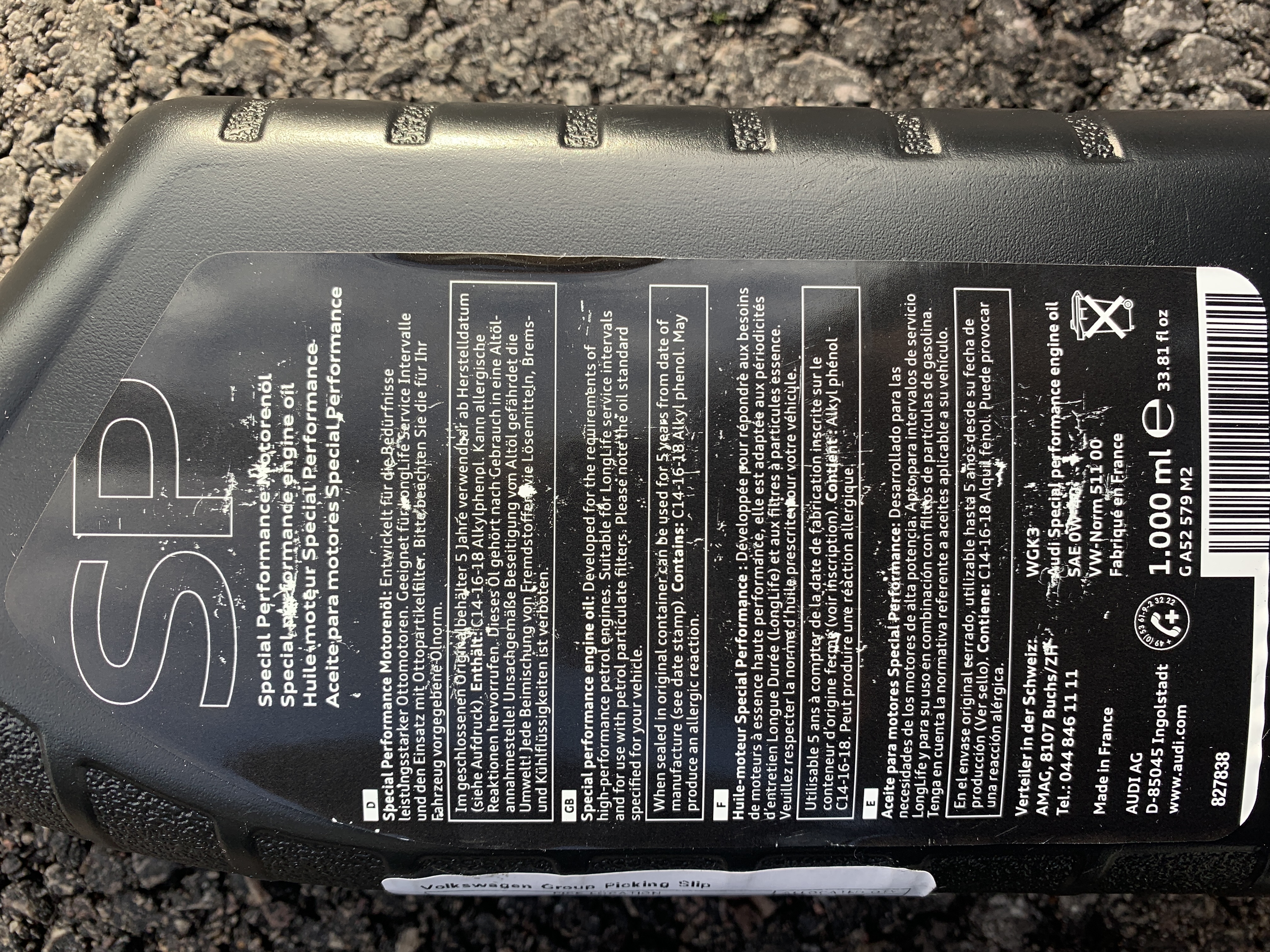

Struggling to find what oil to add, does anyone know if these are these delivered with 5w40?

Mine came with a bottle of Shell Helix Ultra 0w-30

Ordered from dealer but it's 0w-40 weirdly

It’s a special 0w/40 as I just ordered some too

I no would double check. I called the parts department and they had to speak to the mechanics and find the correct oil. It’s definately a 0W/40

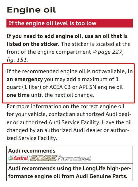

Yeah I also got the same left in my boot, I think its still OK to use but as an emergency, then its an oil change - The stuff I got from Audi I am guessing I can pour away as much as I like!

The oil is
0W/40
51100 Spec

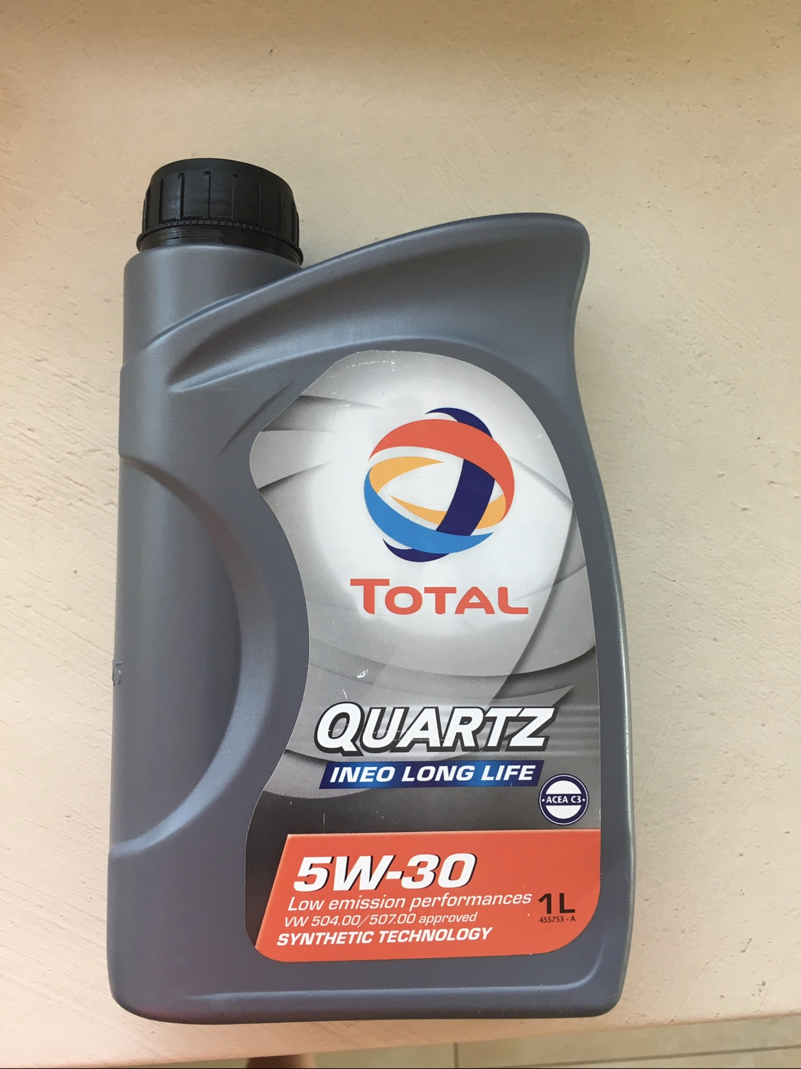

I am using for c7 this oil so I think for c8 should be the same
