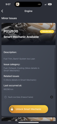

Hi Guys, anyone come across this before?
Audi RS4 2018

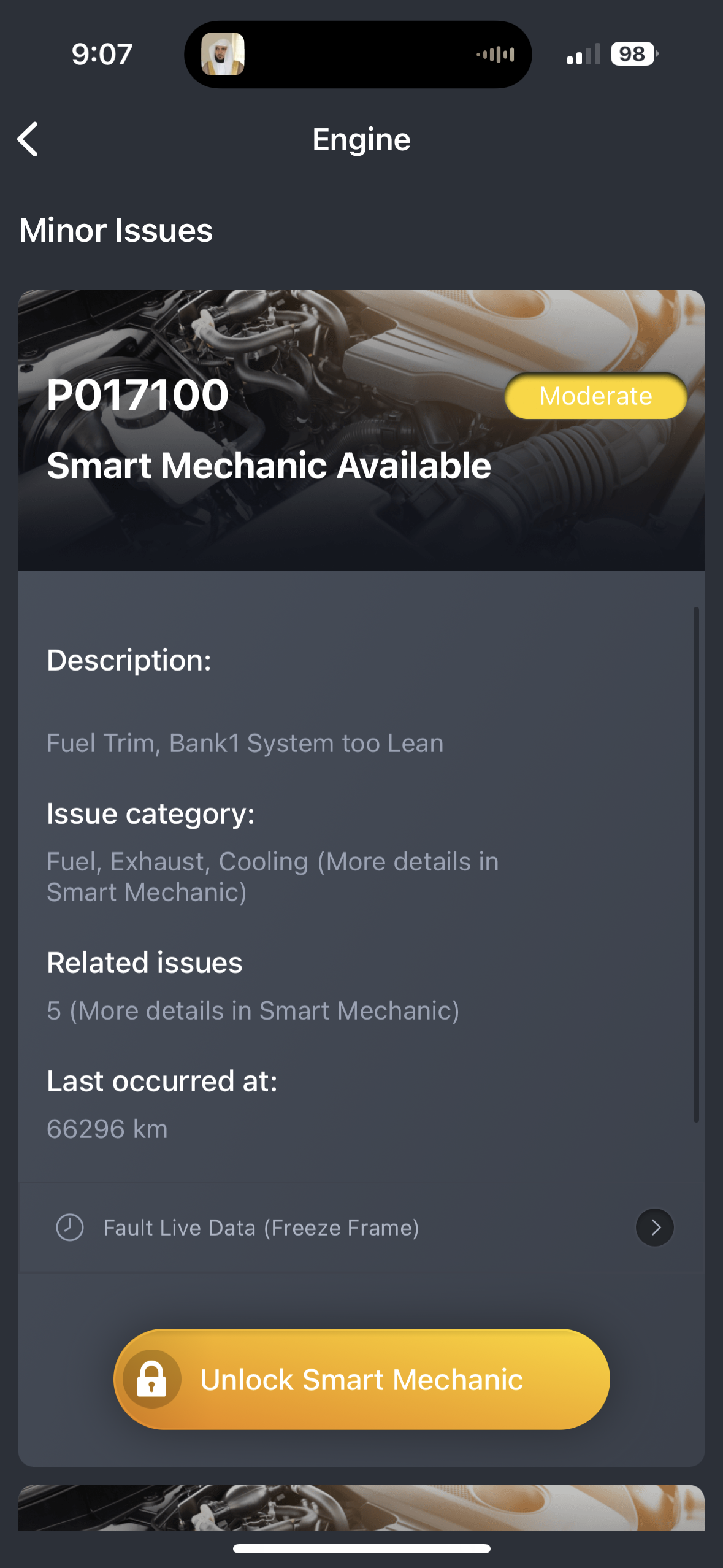

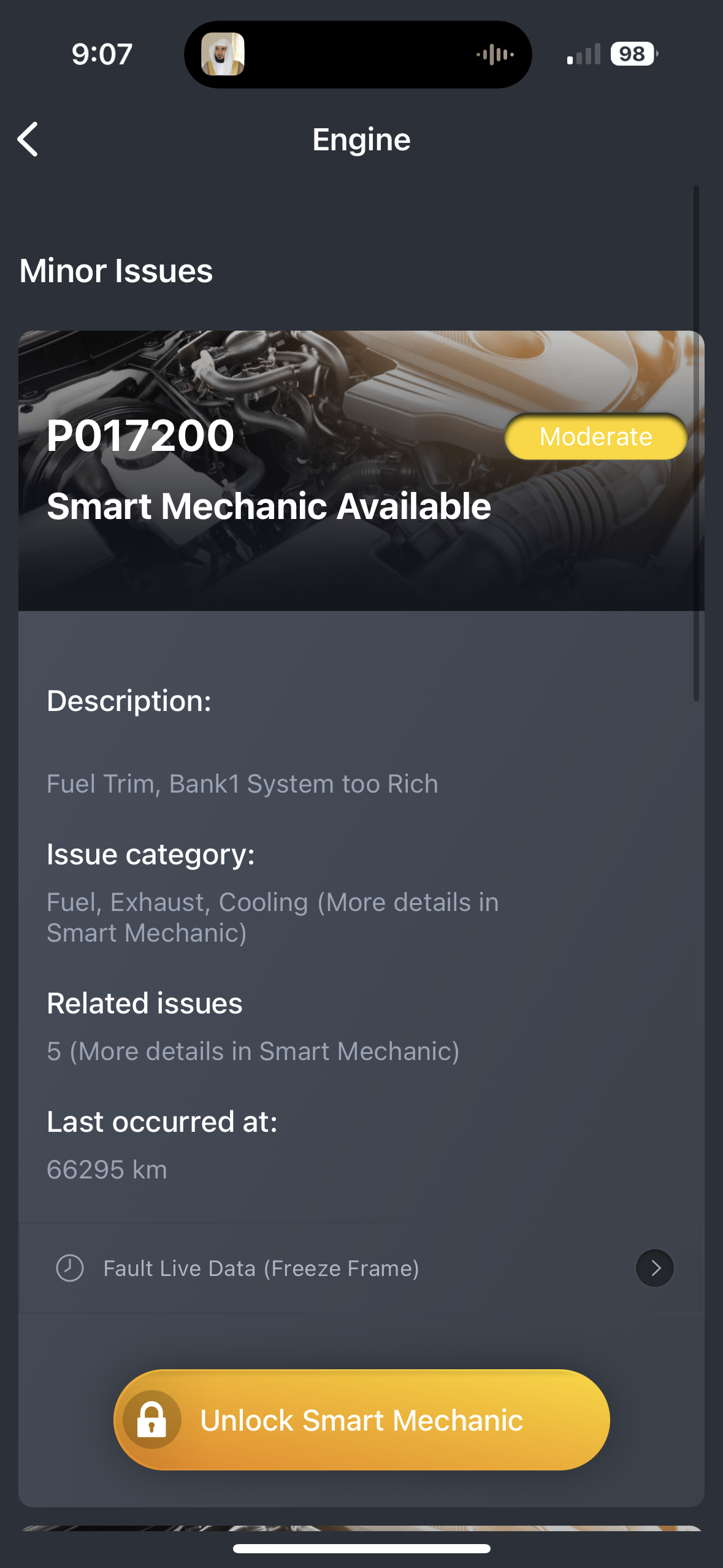

Bank 1 sensor has been replaced. Showing as running too lean and too rich at the same time
Too Lean and Too Rich
