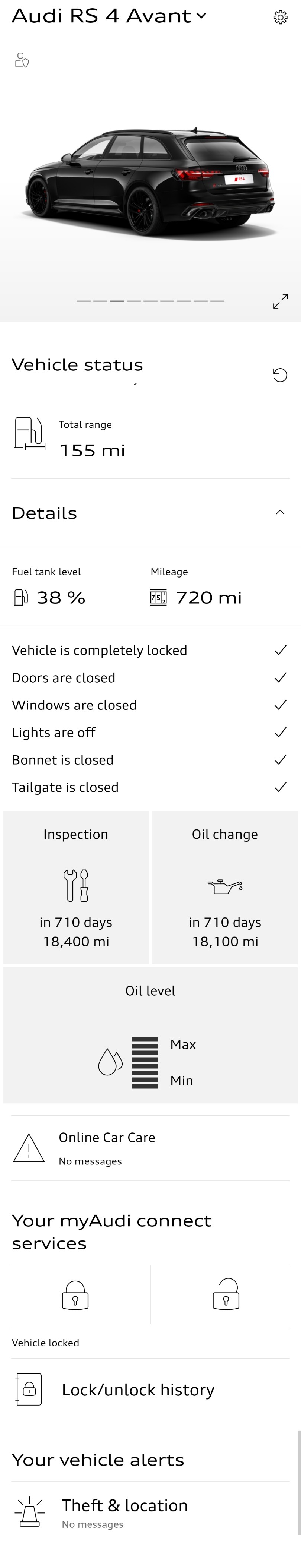

Re: Service Intervals B9.5
My new b9.5 shows 18100 miles until oil change and inspection. Must have long life oil in it I guess. Think I may get my oil/filter changed 1/2 way at about 9000, 18000 seems like a long time

Must check whether mine is set to fixed or variable servicing. My SQ5 was set to annual servicing presumably as my PCP was 10k miles a year. I assume therefore that the RS4 will be similar, which I guess is reasonable but when most of my 10k miles a year are on long journeys it might be unnecessary.Dannyboy123 wrote: ↑Thu Nov 26, 2020 7:18 amMy new b9.5 shows 18100 miles until oil change and inspection. Must have long life oil in it I guess. Think I may get my oil/filter changed 1/2 way at about 9000, 18000 seems like a long time
Like you say though, 18k between oil changes is a lot, but as my brother pointed out, I dont keep cars long enough to worry about the impact it might have!
I wasnt asked but I'm just going off what it says in the myaudi app.

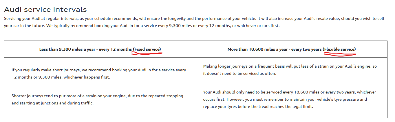

Variable interval servicing is an service/oil change every 2 years
Fixed interval is also a service/oil change every 2 years but with an extra oil change in between so the car never goes more than 12 months without an oil change.
Odd naming, the intervals of both schemes seem quite fixed.
My car was supplied like that (so called Variable interval servicing).Dannyboy123 wrote: ↑Thu Nov 26, 2020 7:45 pmI wasnt asked but I'm just going off what it says in the myaudi app.
They switched it to fixed at the first service (without saying anything) so if, after the first service, you see an oil change in a year and service in 2 years then you will know what happened.
