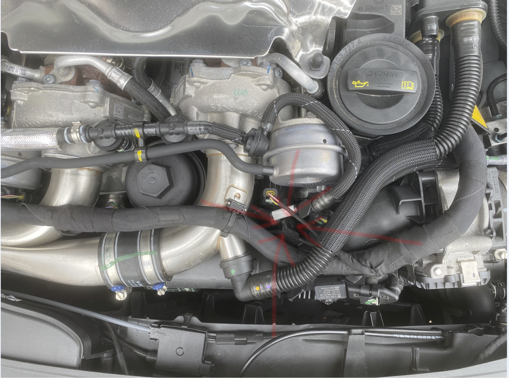

I will answer my own question in the hope that this will help someone who (like me) was embarrassed to ask.
The dipstick tube is at the front of the engine on the left side (near side in UK).
Big break came when I realised the engine cover can be lifted off quite easily (no toolkit required).
