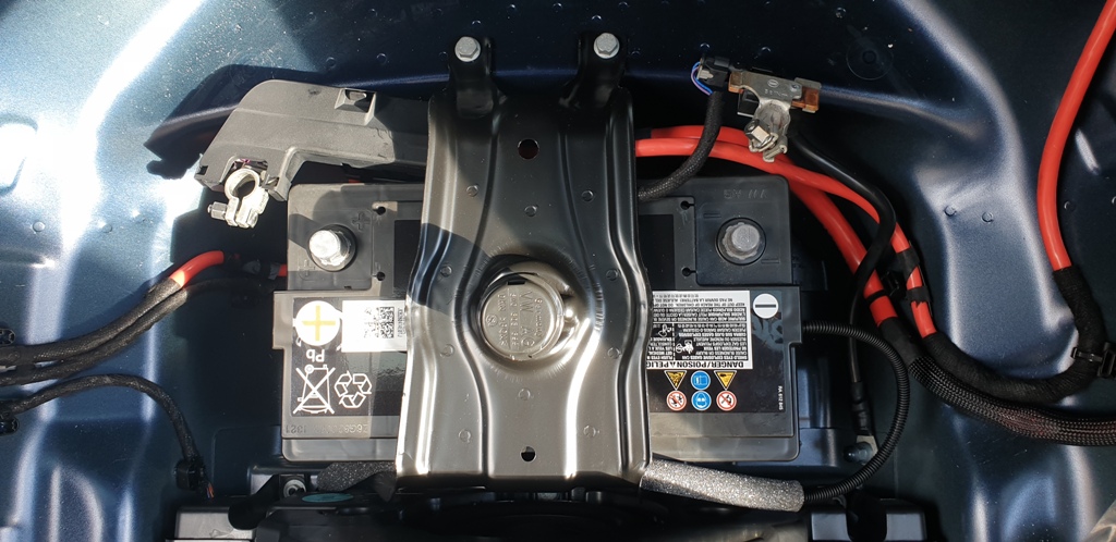

Step 2 disconnect the battery

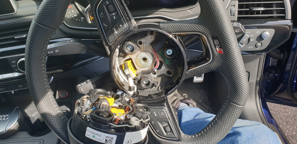

Step 3 remove the air bag using the access holes to release the bag
these are at 4 and 7 o clock on the steering wheel
pull the steering wheel fully out and down to access the locking mechanism
(this was a pain see the video to demonstrate the release of the mechanism
https://www.youtube.com/watch?v=SDxakf1o87E I know its Norwegian but it shows the lock and how to release it this was a pain but persevere you’ll get there

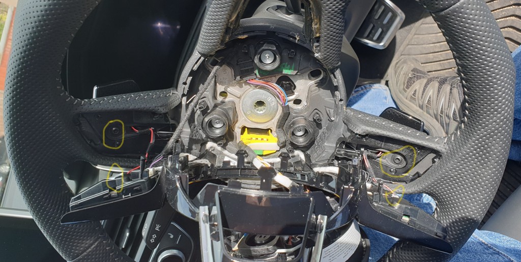

Step 4 Remove the trim on the steering wheel to access the paddle screws and the connectors

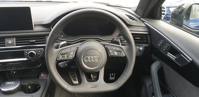

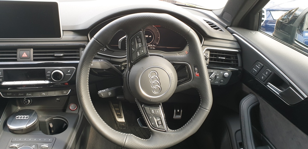

Old paddles

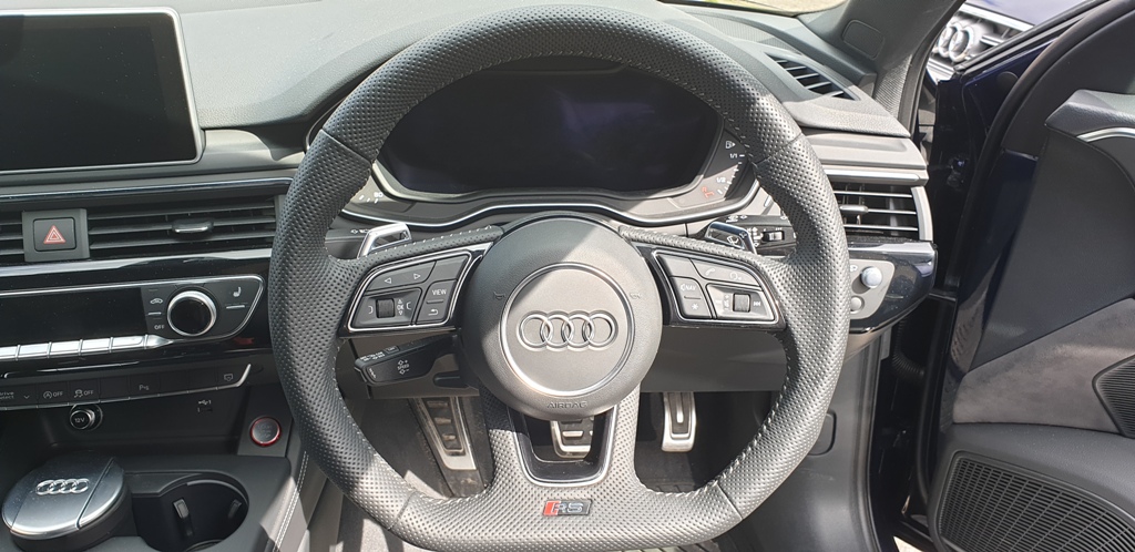

New paddles Then un clip the connectors the just pop out and unscrew the paddle and replace with the new set
Re fit the trim and air bag and reconnect the battery and you’re done
