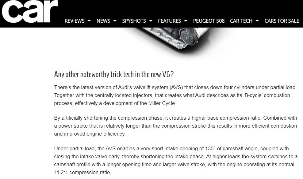

Post by J88NOG » Tue Oct 16, 2018 12:02 pm
I was reading an article about the 2.9 V6 and came across this:
Maybe this explains the 'bump'?
Not sure on what Car's source is though.

Re: Rs4 b9 issue
Post by parkerrs » Tue Oct 16, 2018 12:09 pm
That's interesting.. I'll show it to my Audi dealer & see what they say..
