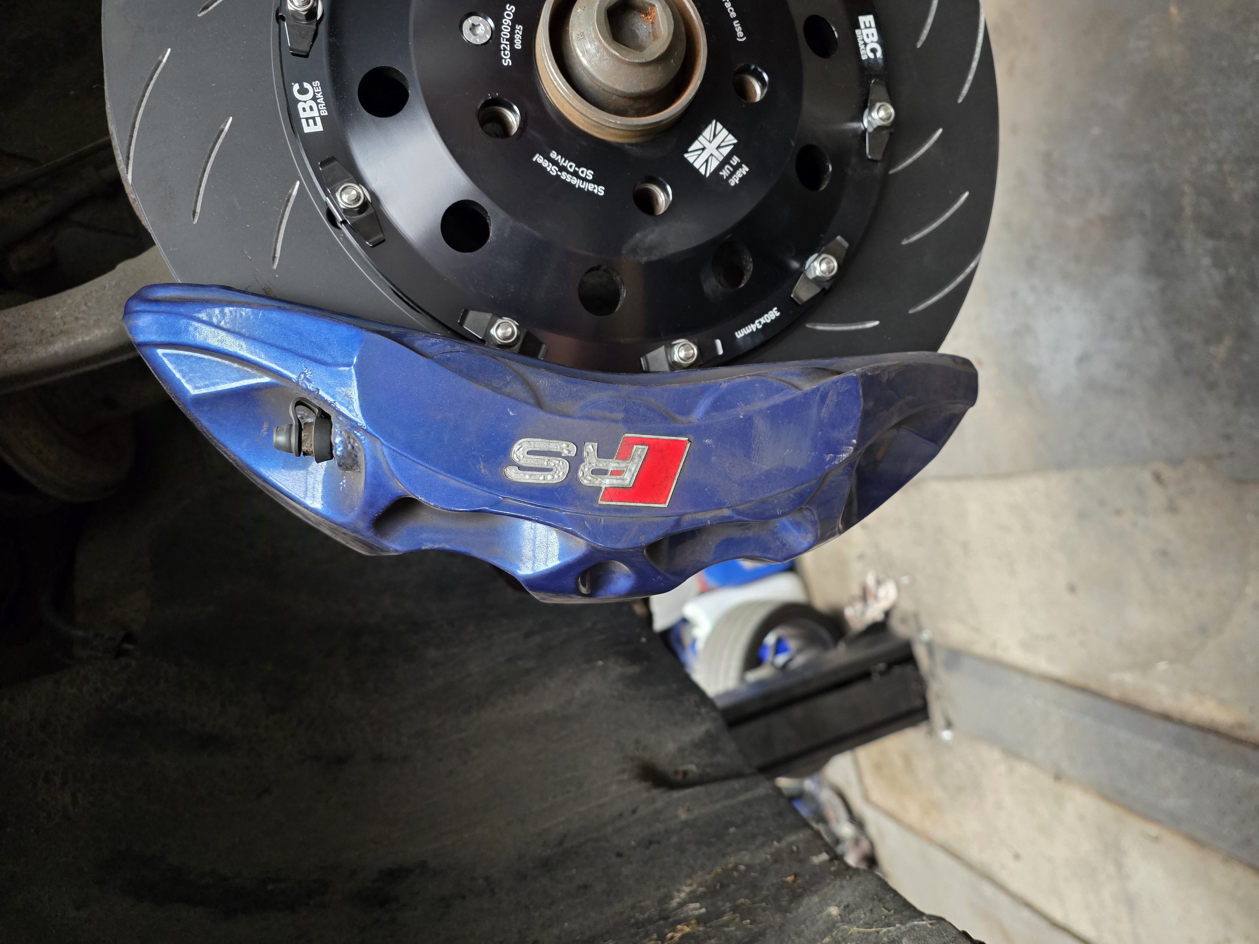

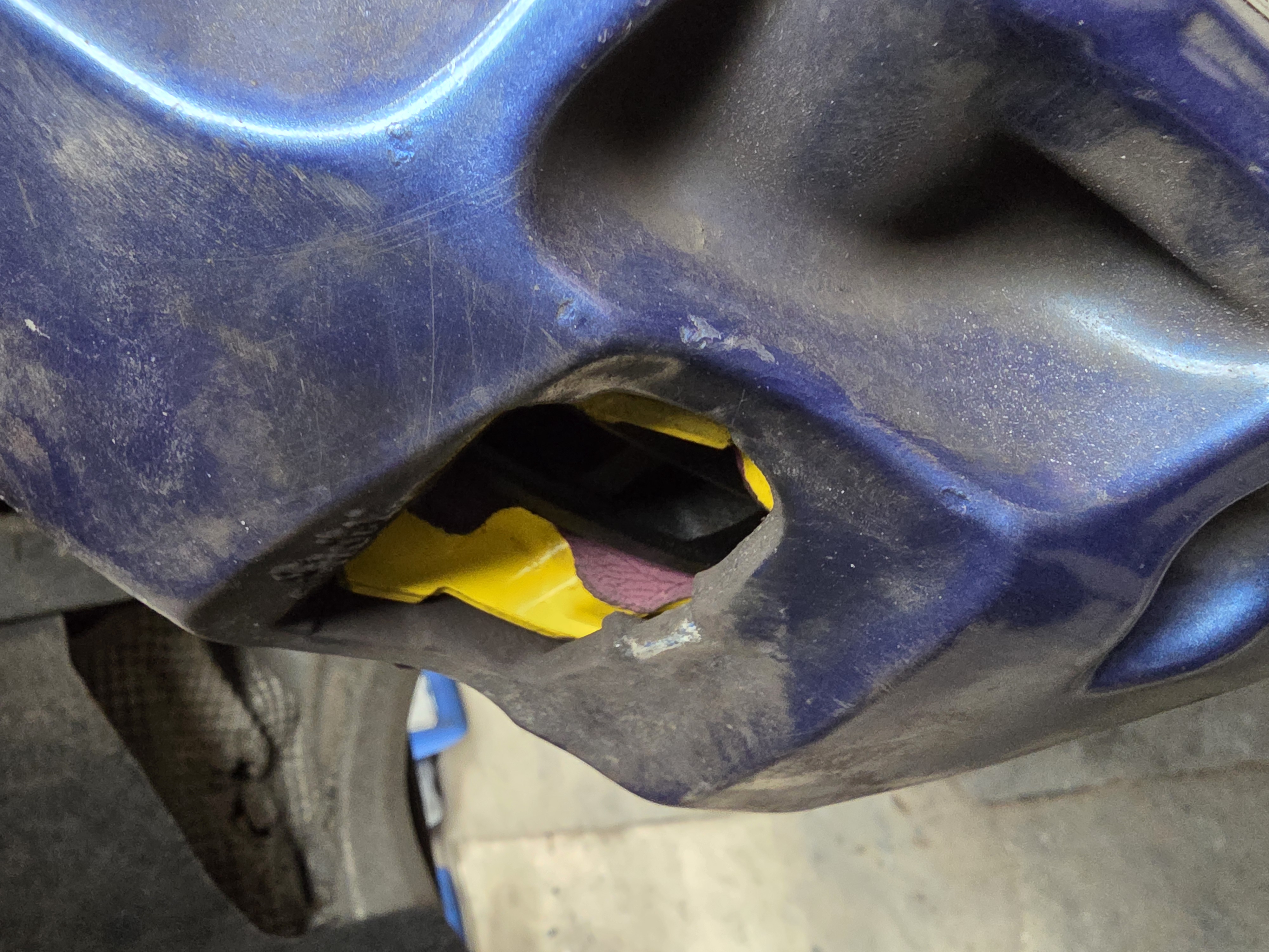

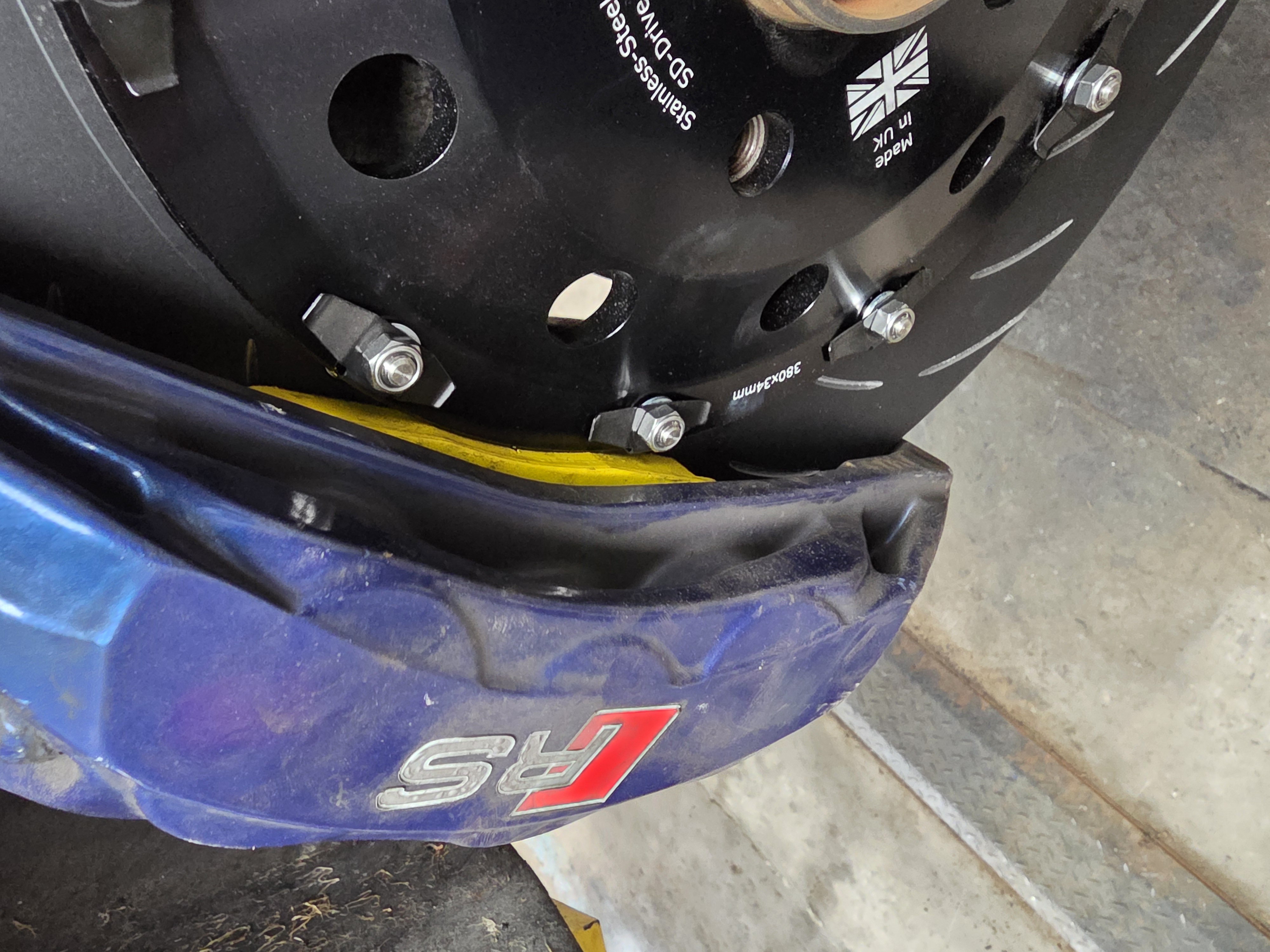

I have a 2014 b8 rs4, but it has non standard front discs & calipers fitted from previous onwer. Went to change discs/pads for ebc 2 piece floating fronts and ebc yellow pads, the pads fit as have worked out the caliper is an Akebono 6 pot so the b9 pads fit.
The problem is the disc bell housing is to big for the caliper to bolt back on. Are the b9 discs a diameter of 375mm or 380mm?

My 2018 RS4 B9 has 375mm x 36mm front disc's.
These are a 'floating' discs with a fixed caliper attached to the front wheel hub. Most cars are solid disc's with 'floating' calipers.

It does help thanks, the lad fitting them for me looked into it aswell, said same thing, 375mm is want I should have!!
May have to sell them or try and get a refund!!
Start again!!
