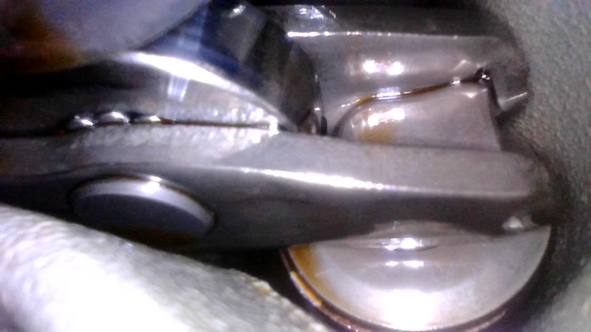

I've got a recording of my car when the rocker arm was failing / had failed

The DECA engines do seem to have quite a noisey high pressure fuel pump / cam noise anyway.
If the engine is on an 2018 build I would assume that it has the old rocker arms, unless the seller can prove otherwise. If you could get the VIN you could ask Audi who may be able to tell you which type the engine was built with. Wether they feel inclined to actually tell you is another thing.
The best way to check is with a small endoscope from Amazon. Remove the oil filler cap, below the filler cap hole is a cam shaft, with a bit of fiddling, look towards the front of the engine and you can see one of the rocker arms and the offending needle rollers. (picture of the old type attached)
To be honest it is hard to tell if the engine tapping is the high pressure fuel pump or a failed / failing rocker arm, unless you could put two side by side. Hence Mirislov's guess at the fuel pump in the video. I wouldn't trust it without a visual.
I think an investment of £80 in and endoscope would more than offset the cost of a £3,600 plus top end rebuild!
