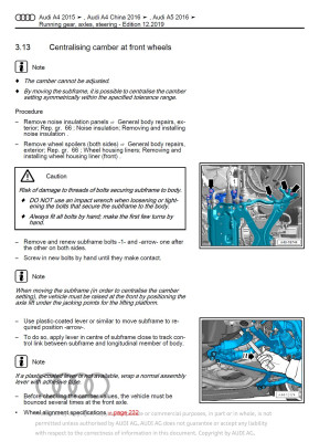

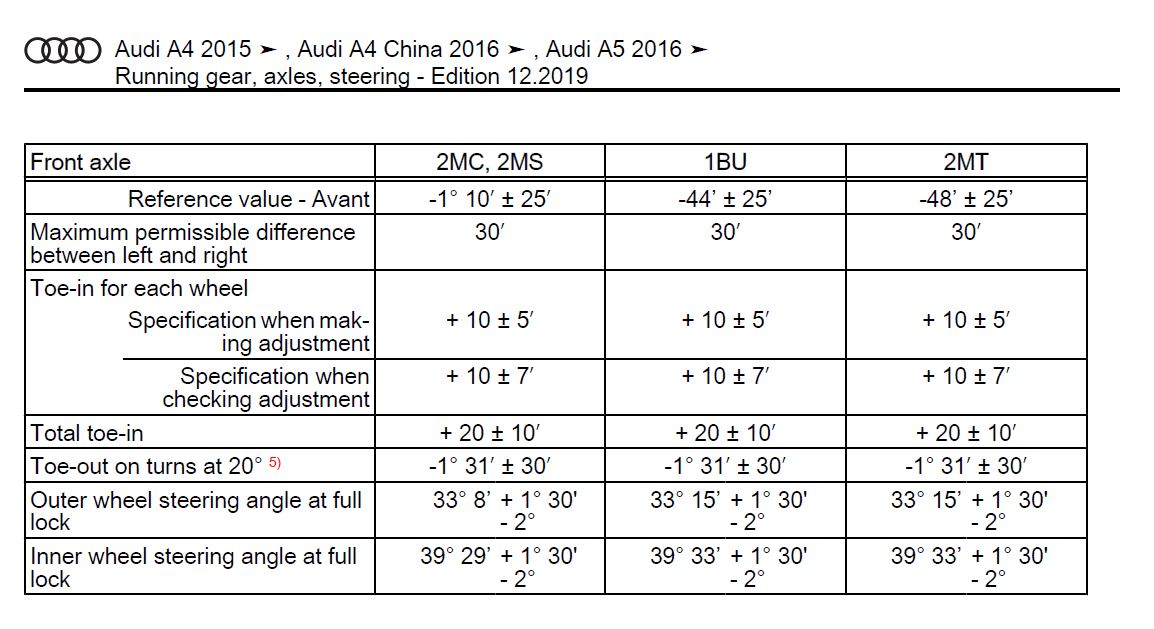

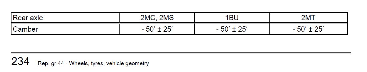

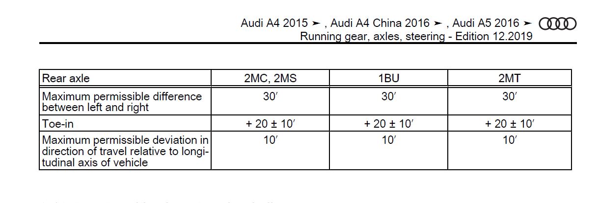

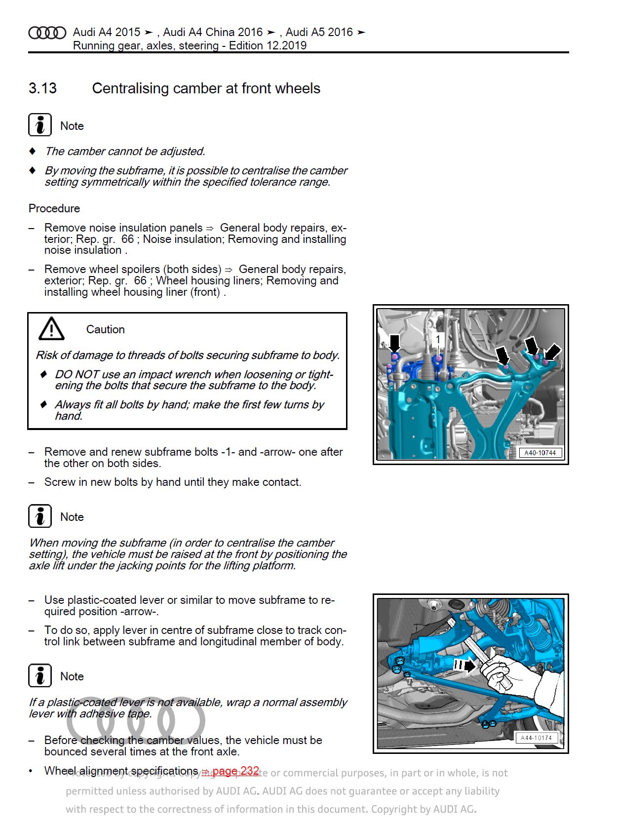

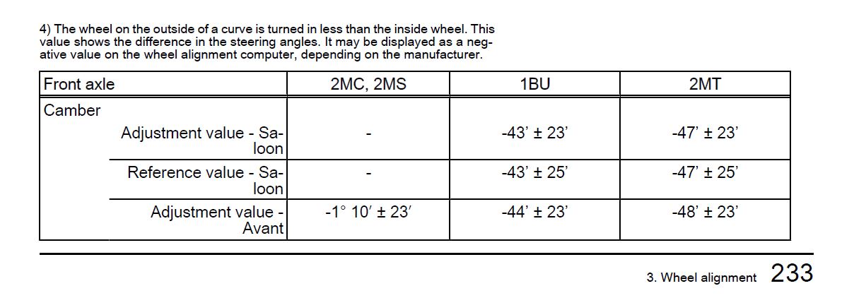

I've had a look in the Audi running gear, axles and steering documentation and in that they say the front camber cannot be adjusted but it can to quote them 'be centralised' so that both sides have the same camber within acceptable limits.
I have attached pages from said document for the 2MC suspension setup (from my build label) which is the setup on my 2018 car, I am assuming Audi haven't changed it since.
This may give you some ammunition when you back and see them. It sounds to me like they couldn't bothered to do the front end fully.

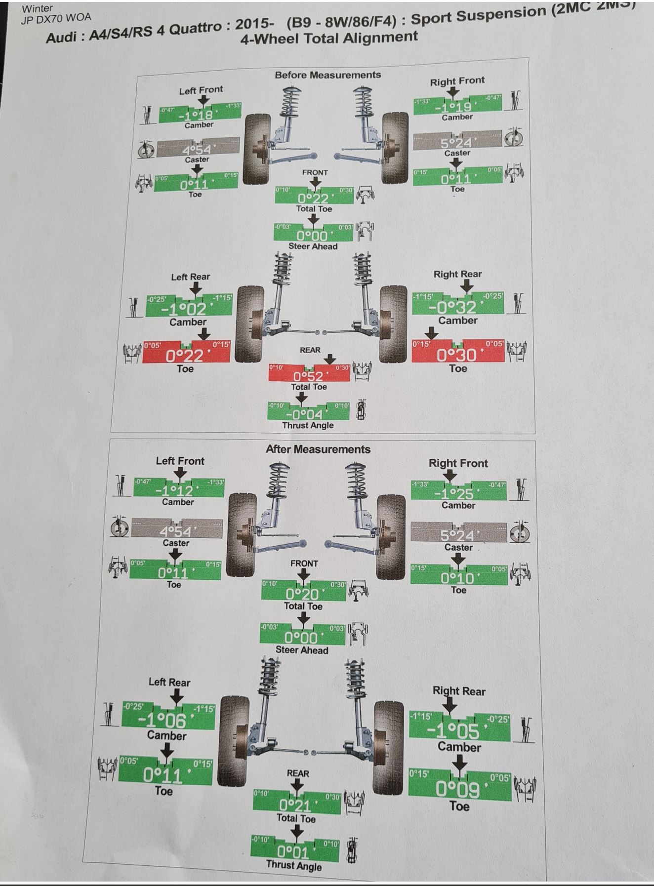

I also found a print out from someone elses alignment, which you will note is a 2MC from 2015

Hi Jools, wow nice, this will be definitely helpful :D
I'll send to them and let's see.
Thank you!

Not a problem, looking at your read out shifting the subframe doesn't look like it will help you, because if you slide it further right while decreasing the right hand camber you will go to nearly zero on the left.

hmm but in this case the subframe needs to be shifted to the left no? then we take some of that right camber (-1°47') and increase on the left that's missing a bit?

Post by smg » Sat Dec 02, 2023 12:00 pm
OK, just an update to this (was waiting almost a month for a spot).
They finally fixed it by doing the subframe shifting:
Seem much better now :)
Thank you all!
