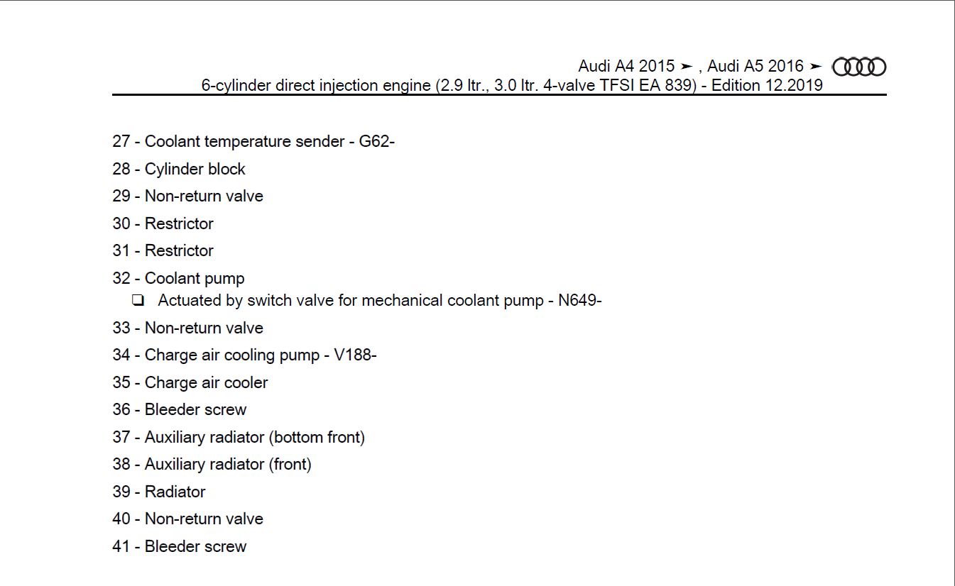

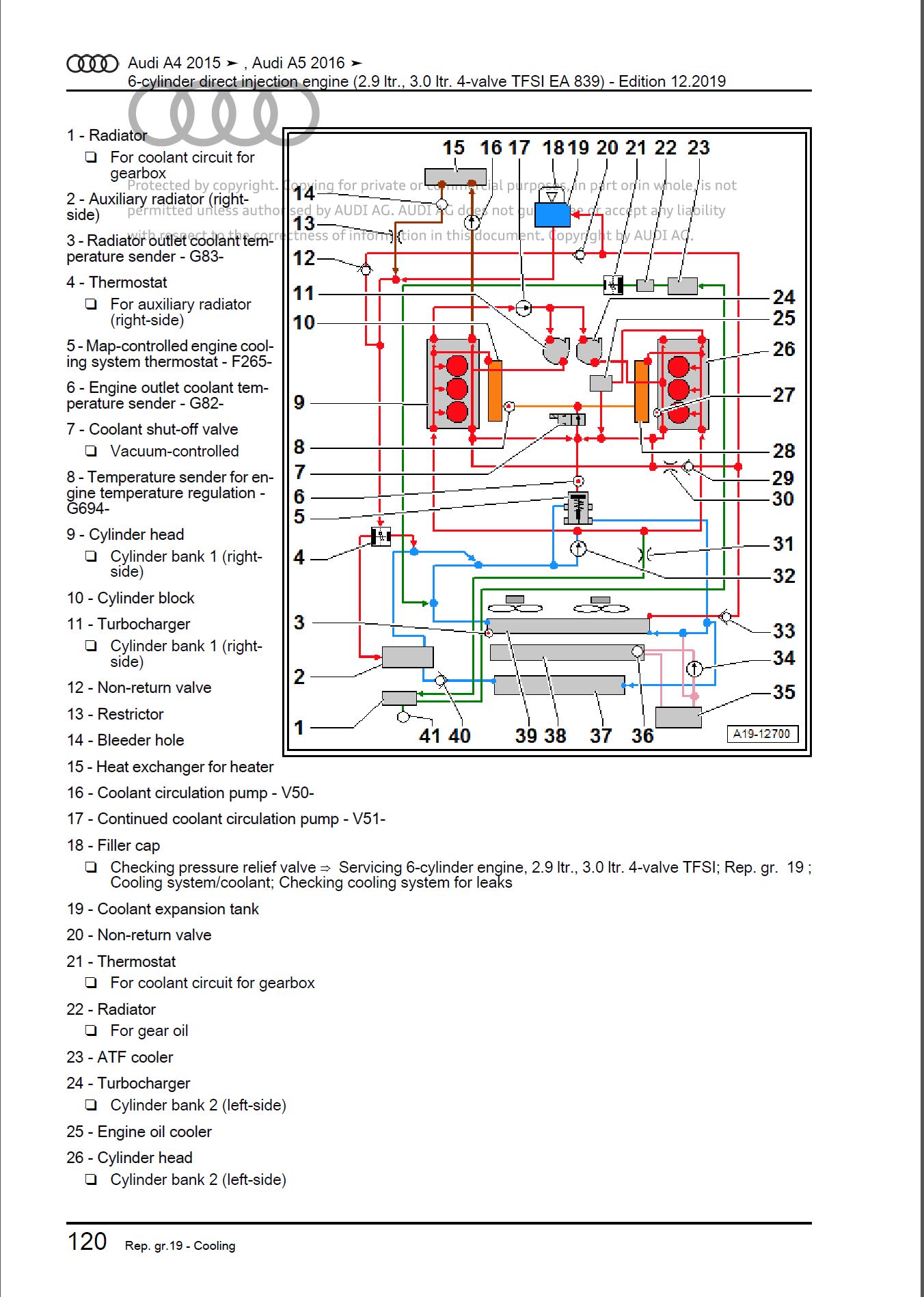

There are four temp sensors on and around the engine from what I can see.
Radiator outlet coolant temperatue, G83
Engine outlet coolant temperature, G82
Engine Block temperature sender, G694
Engine coolant temp sender, G62
I'm guessing from your post that it might be G83, as if it thinks the coolant is too hot coming out of the radiators even if it isn't, it will turn the fans on.
The location is bottom right of the main radiator.
